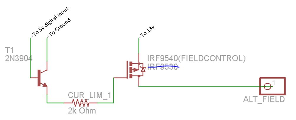

So far everything seems to work except I clearly can’t figure this P-channel MOSFET out (IRF6540)!  No matter what I try I always get a high voltage at the drain pin (full-on condition) regardless of what I do to the gate pin. I uploaded a portion of my schematic as a test circuit I think should work from my limited understanding and online tutorials: http://www.curtismasonjohnson.com/sandbox/ProblemCircuit.JPG
  - The NPN driver in the drawing (2N3904) by itself works when tested with a voltmeter and toggling the input
  - If I replace the p-channel mosfet with a PNP transistor it work as expected. Shouldn’t this mosfet work pretty much the same? My puny TIP127 PNP can't handle the current if I were to hook up the load.
  - I’ve tried several IRF6540 components
  - I’ve tried connecting the MOSFET’s ground pin via a current limiting resistor directly to ground. Also via the resistor to 13v. No voltage change on the drain pin in either case.

The NPN transistor is wired backwards !
I'd like to see a resistor in the base of the NPN too, to stop you punching a hole in it
Connect the emitter to ground. put the resistor from +12 to the collector, connect the collector to the gate of the MOSFET. Field wiring is JUST like a solenoid, you HAVE to put a diode across it to freewheel the current when the mosfet's off.
Put a 10K resistor from 12V to the gate.
...on reflection, make that 10K 100K.

Woops - yeah my schematic was wrong (I keep forgetting what part of the symbol is the collector vs emmitter). Luckily I've been connecting the NPN properly on my breadboard, however (like I said the NPN part has always seemed to work when testing with a multimeter). I've been essentially trying to follow this circuit I found on http://digital-diy.com/general-electronics/67-tip-logic-level-fets-p-channel.html (also added as picture here).
To simplify, however: Even if I set aside everything except just the MOSFET with:
     - the emmitter connected directly to 13v
     - a 10k resistor connecting the base to 13V
     - no load
I still get 13v at the collector when read with a multimeter. Is there a reason this is happening? Shouldn't I get 0v in this condition?
And yeah, interesting you note the blocking diode. While I have actually been using one like you suggest out of fear (my original schematic sucked apparently) I've read a few places that it isn't nessisary for MOSFETs because they act as diodes themselves. Is this true? Seems like I always find conflicting info on that point. The field coil certainly behaves like a pretty massive inductor like you point out.

Got a brand new IRF9540 mosfet today and tried this again using the suggestions from Steve. I created a new schematic drawing below showing exactly how I hooked it up from my understanding of your feedback. Also added a picture of my breadboard; I quadruple checked everything before adding power.
Exactly the same problems as before - the MOSFET won't turn off. I get 2.5 amps of current flowing through the field coil regardless of whether the arduino PWM pin is "on" or "off".  With 12v I would expect to only get this in a full "on" state (the field coil is about 5 ohms). The collector of the npn transistor reads 12v when "off" and 0.3v when "on" (which seems correct).
Ideas?

Your still mixing names
I think you are confused (and confusing.....) about emitters etc. Only bipolar transistors have emitters and collectors and bases. Fets have drains, sources and gates.
I wouldn't trust the body diode for the field of a motor, and besides, that energy has to go somewhere. You don't want it pumped onto your supply rails, or you could blow everything. Put the flywheel diode in.

I'll keep using the protection diodes then. Does the phrase "flywheel diode" imply using a diode specifically in a configuration like in the digital-diy schematic I uploaded above (in parallel with load)? Would the phrase "blocking diode" instead imply that it is used in series with the load? Does the parallel configuration provide better protection (I've been using in series).
You've got to remember FETS are different working principles from BJTS, they have three wires, and control currents and voltages, but there the similarities end.
YES. the diode MUST be in parallel with the load. Yes, it provides better protection, and protection in the right way.
