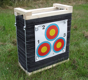

What would be a good way to keep layers of cardboard compressed without using glue so it would have enough friction to stop an arrow ?

get some ethafoam sheets,they are closed cell foam that self heal like rinehart targets.make a vice from two treated 2x6's top -bottom type and all thread as long as you want the target to be and some washers with nuts.tighted untill the compression is what ya what you want then shoot it till ya get fletching deep then replace the damaged layers.for a back stop hang a horse stall mat on the back side loosely.i drill holes in them to fit between top bord and top of the foam before tightening the all thread and allow to hang freely.mines 4'x4'.for the target face. i use paper targets and pin them down with landscape mat staples stiff u shaped wire and punch a hole threw a bottle cap,thread on wire till in the center of the u of the wire and tack the paper target on the corners to the front of the foam and shoot.u could cut some wire coat hangers and bend one end to make a small loop then bend the loop sideways to keep from going threw the foam and paper. the paper targets have alot of different shapes,games etc....hope this helps,i would show mine but my cameras broke,sorry.shoot well,shoot streight and shoot often.

I assume you're firing into the plane of the card? Why not think laterally? Make a whole pile of strips of corrugated card, with the corrugations running between the two long sides. Make three sides of a wooden frame in a U the size of your target, and make the strips as long as the target is wide. Stack the strips up inside the frame until you get a centimetre or two above the top of the frame, then screw on the fourth side of the frame - this will compress the strips, and lock them in place. The arrows will pierce the target and then wedge in the holes of the card. If that isn't enough, either make a second frame to go behind the first, make a whole new frame that's thicker, of just stand further back and improve your aim. BTW, why no glue?
Pat Sowers (author) in reply to KitemanAug 30, 2007. 2:33 PM
thats what I was thinking of but I used the foam from my old target and compressed it with the wood it works well thanks for the idea.
