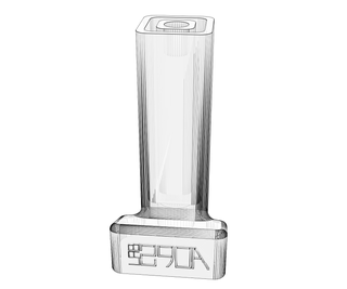

The bottom piece has an outside wall for looks, and a center column to hold up the brass insert for the adjustment mechanism. The upper piece has a single hollow square tube that fits in the small gap in the lower piece, and a shoulder at the top to match the lower outside wall.
You'll also notice that I have added fillets to any inside corner that it was feasible. This reduces stress at the corner and makes the part stronger overall.
Step 6: Making the Adapter Stand on Its Own One Foot
I've added a wider "foot" on the lower piece. This isn't strictly necessary, but it makes the adapter stable enough to hold up my iPhone 6 on a flat surface like a desk or table without a tripod.
