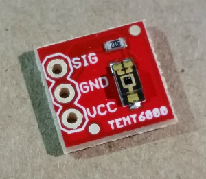

1Ambient Light Sensor1SparkFun

Connecting the Ambient Light Sensor
For the ambient light sensor, GND connects to ground, VCC (which is joined to the wire from the temperature/humidity sensor) connects to 3.3V, and SIG connects to A3.

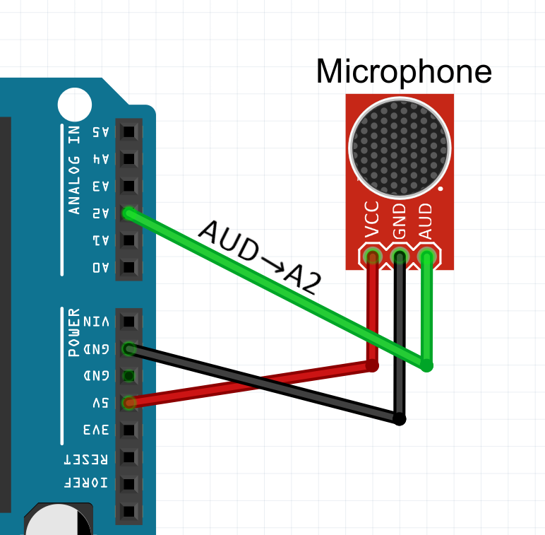

Connecting the Microphone
For the microphone, GND connects to ground, VCC connects to 5V, and AUD connects to A2.

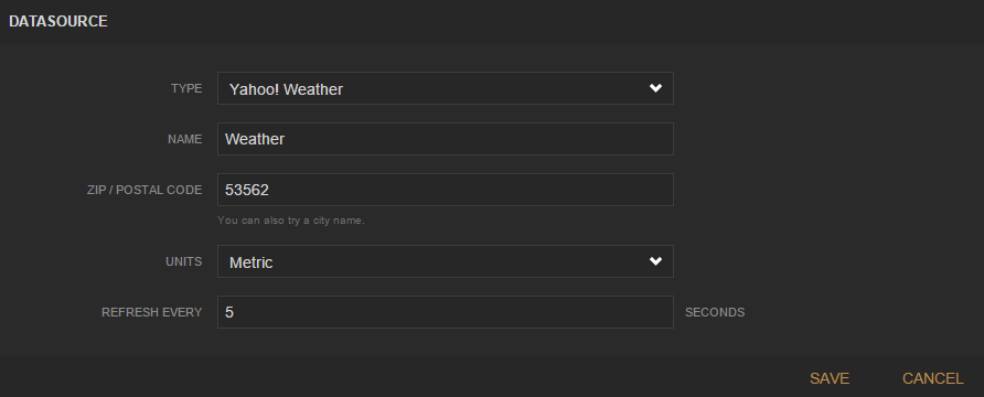

Begin by clicking the ADD button in the upper-right corner of the screen. In the TYPE dropdown, choose Clock. Once you select this option, two additional options will appear. In the NAME field, give this data source a name that will allow you to differentiate it from the other data sources we will be adding, I named mine Datetime. Then, in the REFRESH EVERY field, input 1 second, which should be the default value. Finally, click SAVE.
That's one data source down and two to go. Click the ADD button again. This time, in the TYPE dropdown, select Yahoo! Weather. As before, a number of other fields will appear once you select this option. In the NAME field, enter Weather. In the ZIP/POSTAL CODE field, input your zip code. In the UNITS field, choose either Imperial or Metric, depending upon your preference. In the last field, REFRESH EVERY, input 5 seconds. Then click SAVE.
Now for the last, and probably most important, data source. We will add a Dweet.io data source which will allow Freeboard.io to pull information pushed to Dweet.io from our Arduino IoT sensor. Again click the ADD button in the upper-right corner. In the TYPE dropdown, select Dweet.io. In the NAME field, input Dweet.io. Then, in the THING NAME field, input the Thing name you used in your Arduino sketch as described in the previous step. The last field, KEY, will be left blank unless you've paid for a private key on Dweet.io. Last, click SAVE.

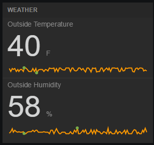

That's one Pane finished. We will need to add a total of four more Panes: weather, time, inside conditions, and inside light level. To add our next Pane, click the ADD PANE button again. As before a blank Pane will appear at the top of the page. Click and drag the Pane below the Inside Sound Level Pane we just added. Click the Wrench icon and in the TITLE field input Weather. Leave the COLUMNS field as 1.
Click the + (plus) icon. In the TYPE dropdown, select Text. In the TITLE field, input Outside Temperature. In the SIZE dropdown, select Big. In the VALUE field, input datasources["Weather"]["current_temp"]. Set both the INCLUDE SPARKLINE and the ANIMATE VALUE CHANGES to YES. Last, set the units to correspond with the value, Imperial or Metric, you set for the Yahoo! Weather data source and click SAVE.
Click the + (plus) icon on the Weather pane again and input all the same values you just did except give this Widget a title of Outside Humidity, and in the VALUE field, enter datasources["Weather"]["humidity"].
