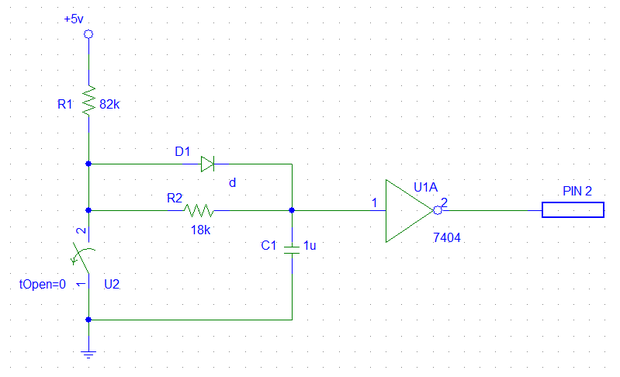

The problem with this setup was when the button was pressed the interrupt was being called multiple times and even toggling other buttons. Why was this happening? It is caused from a switch bouncing feedback. To fix this, you need to modify your circuit around this manner below:
hi2
What this did was when the push button was on (=1) the pin was HIGH and only HIGH. It never bounces around like it used to.
The project that I was working on had the following schematic (created with PSpice Student 9.1).
hi3
The pin configuration is as follows:
