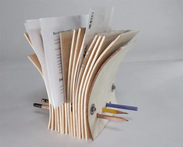

Introduction: Bent Plywood Paper Holder
This desktop paper organizer uses leafs of bent plywood to keep things in order. Simple in design, the pieces of curved plywood are reminiscent of book pages. The bottom portion of the paper holder has small openings to keep pencils or other small tools.
I managed to use scrap pieces of 1/8" plywood for my design, and think the irregular nature of the pieces adds to the look. This project can be scaled up or down to accommodate all kinds of things, from notes to magazines, and uses only 2 threaded rods to keep everything together.

Step 8: Clamp and Drill
Once the pieces have been arranged I tamped the stack on the bottom to make the pieces even, then clamped them together using a spring clamp.
I measured about 2" form the bottom and 3/4" from the edge and drilled a 1/4" opening through the entire stack. The spring clamp was moved and a matching opening was drilled on the other side of the stack.

Step 13: Drill Pencil Slot
I decided to use the space at the bottom of the stack to hold pencils.
I measured and marked an array of 4 openings in the bottom area of my plywood stack, then used drill bit slightly larger than the diameter of a pencil to create the openings. Going slow here will prevent tearout. Any debris from drilling can be easily cleared from between the sheets because of the washer spacers.
Step 14: Store Your Stuff!
Your plywood paper stacker is ready for your desk at home, or the office! The plywood can be coated with varnish, or left natural.
Your plywood paper stacker can be made as large or small as you like, maybe scale it up even bigger to fit magazines or use as a stool!
