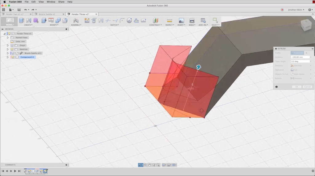

I extrude this profile to cut the original mass. I have to turn off the Bicycle Saddle component so the extrusion doesn’t cut this too.

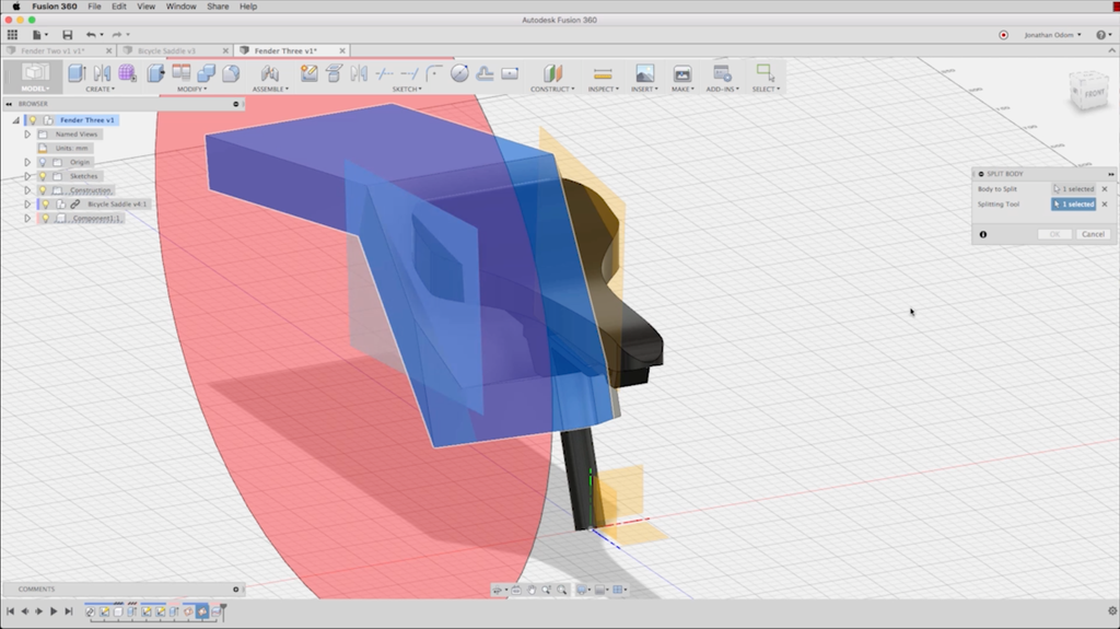

The form isn’t quite finished yet- it still looks too bulky to me, and I don’t like the extra facet created by the last cutting operation. I choose Plane from 3 Points in the Construct menu to create a plane that I’ll use to split the mass, then repeat the same plane on the opposite side.
I then go to Split Body in the Modify menu and split the mass using these two new planes. The result has a better profile than the previous version.

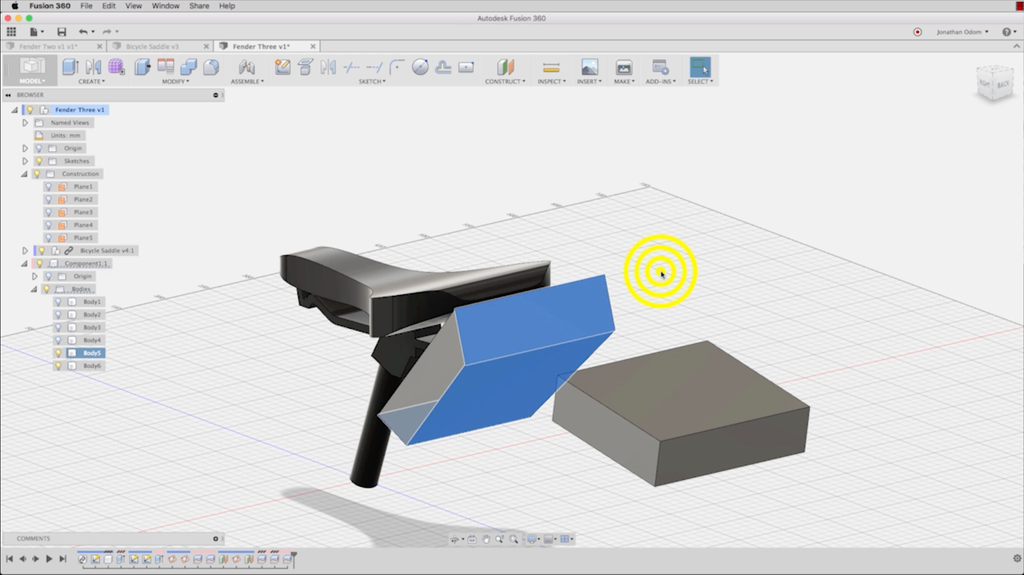

The two obvious places to make seams are (1) along the top plane of the clamp element, and (2) at the elbow where the vertical part and the end part meet. The tail end is too long to fit on the printer bed whole, so I create another cutting plane at about half-way down the length.
Modify > Split Body
I use the Split Body Tool under Modify in the menu again to split the mass along each of the cutting planes.
