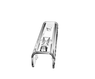

Step 4: Industrial Design Engineering: Internal Placement of the Parts
For this step, I've modeled all internal parts and electronic modules as solidsorks parts.
I did the internal placement to find the optimum case shape and dimensions before continuing the 3d modeling of my design. I did some modifications to the design according to the needs arised during this placement process. I've used solidworks' assembly mode for this purpose.
Step 5: Industrial Design Engineering: the 3d Modeling
The modeling of the product case is straightforward, in summary it starts with a rectangular prism. Turns into required form step by step, then it is cut into required parts, added internal details and thats it. I've just selected several of the modeling steps on which a visible difference is done, in fact there are a little bir more than this :D
There are 3 parts at the final work, upper body, lower body and the internal support part.
No screwing is required internally or externally including the electronic cards. The parts locks on each other securing themselves very firmly. The internal support part divides the main interior space into two; battery space and the electronics space. While it counters the mechanic force applied by the battery & spring, it also applies support to the power&charging modules, holding them in place when the plugs are being inserted.
As i said, the case locks up itself, I mean really locks up. So the builder should be sure the device works properly before closing the case or it might be a little difficult (:) to open it back up.
