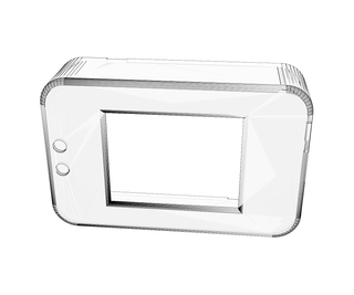

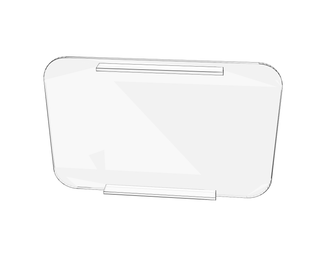

Step 10: 3D Print the Case
You can download the STL files and 3D print the case in any color you want. The case features holes for the berg connectors and IR sensor.
