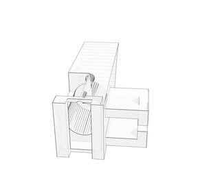

Step 2: The Case
I 3d printed my case and the file should be to scale, but if you don't have one I would love to see one of these made from wood or something!
Also due to some concerns about glare I added the "Glare Killer" STL file. It has a small wall to help minimize glare, I made it 15mm long so it could be snipped if to long.
Step 3: Batteries
After you have made the case you must insert the batteries. First you must solder a small segment of your wire to a small piece of your metal sheet. Next insert this onto the bottom of the case. Now you can insert the batteries!
Step 4: Switches and LEDs
I salvaged some leds somewhere and they were on a small pcb board so I'm using that, but I designed the case so you could also use single leds.
First I crimped a small sheet of metal to fill in any extra space between the led(s) and the batteries. I than soldered the crimped piece of metal to the led(s) and places it in. using electrical tape I covered any other connections so that I wouldn't short the circuit. Than I glued the led(s) onto the front.
The switch is easy all you have to do is connect the rest of the two wires together, soldering one to the middle lead and the other wire to a lead on the side. When you have made sure that works glue that switch onto the side of the case!
