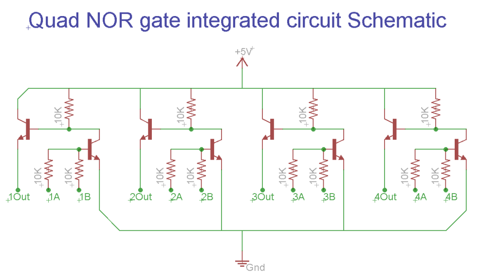

Step 2: The Schematic
Picture of The Schematic
The Schematic of a NOR gate is shown above, as well as the schematic of a generic Quad NOR Gate IC. The latter is rather big, so I have manually inserted it below.
HOW DOES THIS WORK?
The function of a NOR gate is as follows:
  • When both inputs A and B are LOW, our NOR gate outputs a 1 (HIGH state)
  • If either A or B is HIGH, our NOR gate outputs a 0 (LOW state)
  • And finally, if both inputs A and B are HIGH, our NOR gate will output a 0 (LOW state)

Can I use 1K resistors? I have currently 20.
jensenr30 (author)FaizulI2015-09-28
You can use 1 kohm resistors.
Sidenotes:
With 1 kohm resistors, each NOR gate will consume more power, depending on its state.
You could use100 kohm resistors instead of 10 kohm resistors (the exact value is not critical).
Higher resistor values may limit the speed of the gates.
