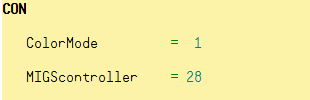

Start by typing the following three lines:
Remember the CON section allows us to establish rules which will be CONstant throughout the operation of our program.   Typing CON tells the Propeller Tool which section we are creating, turning the background yellow for this section.   In this CON we have established that the words ColorMode is equal to decimal number 1, and MIGScontroller is equal to decimal number 28.   These settings will remain this way during the entire operation of the program.
Here's what these two settings do!
ColorMode = 1 sets the SLUG VGA driver to 256 color mode.   If you are using a Pocket Computer 256 or VGAplus256 board this is a correct setting.   If you are using a Human Interface Board or Parallax Demoboard, set Colormode = 0 for 64 color mode.   If you are using a board which incorporates a TV output, this setting won't matter either direction.
MIGScontroller = 28 sets the "base pin" for our controller.   You will need to change this depending on what controller you are using.
Here are some very common settings:
  • MIGScontroller = 28  Setting for Wii Classic Pro/Nunchuck on VGAplus256
  • MIGScontroller = 26  Setting for Keyboard on Human Interface Board, Demoboard, VGAplus, and VGAplus256
  • MIGScontroller = 24  Setting for Wii Classic Pro/Nunchuck on Quickplayer Extreme
  • MIGScontroller = 3    Setting for El' Jugador
  • MIGScontroller = 0    Setting for NES on C3.  (Pin ignored)

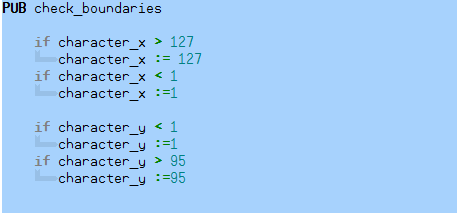

If you were to actually run the program right now, without the check_boundaries section in each of the if condition statements our little pointer would quickly run of the edge of the screen, or worse cause the TV version of the video driver to simply crash.
Remember from chapter 1 that we have 128 blocks across the screen (or X) and we have 96 blocks we can draw from the top of the screen to the bottom of the screen. (or Y)
By keeping track of the character_x and character_y numbers as they change we can prevent a crash or undesired effect.
Add a few blank lines below your code and let's create another PUB function called check_boundaries.
We have four different checks we are running.
Let's break down the four if conditions:
  • If character_x is greater than 127 then character_x is set to 127.
  • if character_x is less than 0 then character_x is set to 0
  • if character_y is less than 0 then character_y is set to 0
  • if character_y is greater than 95 then character_y is set to 95
This insures a nice "boundary" which is checked every time a button is pressed in our original if MIGS condition statements.

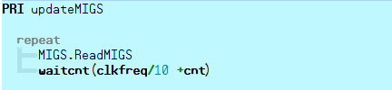

This time we are creating a PRIvate function which facilitates the migs_wiiclassic.spin driver.   I'll talk more about multiple cogs in the next chapter, so for now simply add the four lines.
