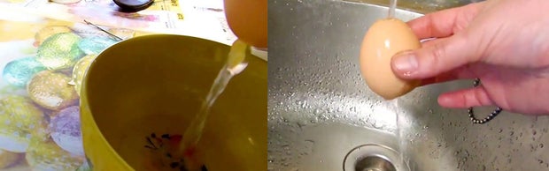

Prepare the egg
  • Make a hole in the bottom of the egg with the small needle and poke around to break the yolk.
  • Make a hole in the top of the egg with the bigger needle.
  • Blow the bottom hole until the egg is completely empty.
  • Rinse the egg shell on the outside as well as on the inside.

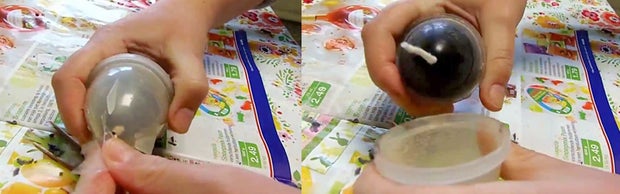

Step 4: Egg Candle Using a Candle Mold
Materials needed
  • egg shaped candle mold
  • tape
  • stick
  • candle wick
  • optional: egg holder, aluminum paper
Prepare the mold
  • Pull the wick through the mold.
  • Tie the bottom part of the wick to a stick and rest it in the slits of the mold.
  • Pull the wick tight and keep in place with tape. Use more tape to seal the hole.
  • Cut the wick.
Make the candle
  • Place the mold on a flat surface.
  • Pour in a little bit of the (somewhat cooled) wax and check if it spills in the bottom.
    • If it doesn't spill, you can slowly pour the rest of the wax in.
    • If it does spill, your wax is either too hot or the tape wasn't positioned correctly. Wait until the wax left inside the mold hardens and covers the hole that way. Then carefully pour in the rest of the wax.
  • Wax shrinks when it hardens, so just as with the first candle, you'll need to keep filling the hole in the bottom until there is not longer a hole left when the candle has hardened completely.
  • Remove the tape and the stick first.
  • The easiest way to remove the mold is by twisting the mold parts seperately.
  • If you'd like your candle to be able to stand on it's own, turn on your stove, place a piece of aluminum foil on it and melt the bottom.
  • You can clean your mold with dish soap and water.
