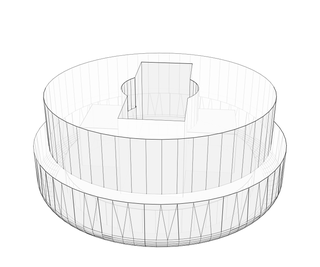

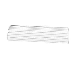

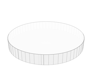

In order to hold up the led strings (since they are doubled over in the tubes) and to cover the top of the tubes, we designed and 3D printed caps for the tubes, as shown in the photos and files above. We used a makerbot printer to print the caps with these settings: structures and rafts on, infill at 13% and 2 shells. The outer diameter should be 2.5" and the inner diameter should be slightly less than 2.25". The cap's lid should be slightly less than 2" in order to snap into the rest of the cap. You may have to vary these settings slightly based on you 3D printer.
