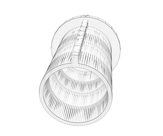

With the width of the Code Dial now determined, we can now design our cylinders. We’ll start with the Dial Cylinder.
Step 4: DESIGN - the Dial Cylinder
OK, Now we’ve got the hang of how to use SketchUp. We should be able to design the next pieces a little quicker.
First, make a copy of the “Cryptex Start.skp” file and name it to “Cryptex Dial Cylinder.skp” or an equivalent. This will be the file that we use for editing in this step.
The Dial Cylinder will need to have an end plate at one end to keep the dials on. For this, Pull all of the surfaces up a desired thickness. For ours, we chose 6mm. You may want to go a little thicker, just so that when you are separating the two halves of the Cryptex, it is easier to grab on to.
Now that we have the end plate ready, we need to create the cylinder. This is the cylinder that holds the Code Dials. It also allows the lock posts of the Prize Cylinder to pass through for locking with the Code Dials. To create this gap for the posts, I used the Tape Measure Tool and measured in 0.5mm from a segment corner. When doing this, a guide is placed for later use. I then do the same on the opposite side of the segment. From these guide point, draw lines to the center. When I create the cylinder this portion will not be pulled, thus creating the desired gap. Having an angled gap shouldn’t be a problem for our design.
NOTE: My first attempt was to raise the cylinder, draw lines along the length and then push the gap through the cylinder wall. Because the cylinder was a circular surface and not linear, SketchUp did not allow the Push/Pull tool to be used. For another method for creating this gap, see how I created the locking posts on the Prize Cylinder.
Next, we need to determine the height that we want to pull the cylinder up to. With 7 rings at 12mm, we’d have a distance of 84mm. We will also be adding a keeper ring to hold the dials in place, so I added 2mm for it to be secured to, plus an additional 0.5mm of gap. That brought me to a cylinder height of 86.5mm.
Now, Pull the appropriate ring for the Dial Cylinder to 86.5mm.
When assembled, the gap won’t be seen by the operator, so we need to draw an indicator so that they know where to align the combination. We’ll add an Arrow indicator for this. To do this, I used the Tape Measure tool and measured in from each edge of the appropriate segment 1mm. Then, draw a line from each of the lower corners to the midpoint of the top line and then a line between the lower corners. This creates a triangle. Pull the triangle out 1mm.
SKETCHUP TIP: Using the Tape Measure Tool to create guide points from a line generally creates a guide line. Measuring from a point creates a guide point.
This cylinder is now complete.
Save the file as .SKP.
Now, Export the .STL and this part is now ready to take to the printer.

Step 11: MOLDING - the Dial Cylinder
The Dial Cylinder is a one piece pour as it does not need to have exact finished dimensions for the end cap.
For this mold, I used a nut can and it worked out wonderfully. For this one, the top end cap is glued to the bottom of the nut can.
Spray the Dial Cylinder with Mold Release.
Mix the silicone and pour enough silicone to cover the part to at least a half inch above the highest point in the model.
Allow to cure and then demold the object. When we cast the model, we will simply fill until it reaches the top of your mold.
I do want to note here to be careful with the demolding of the printed model. I broke ours off inside and needed to repair it with epoxy.
