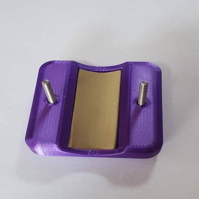

101. Joystick holder Base (print in muted color so as to not distract driver from the joystick handle; use Onshape CAD if you want to make changes)
102. Joystick holder Lid (print in muted color)
103. Joystick holder Clamp (print in muted color)

7.09. Cut a 19mm x 45mm piece of 1/16” rubber gasket (26).
7.10. Put the piece of rubber into the recessed rectangle of the joystick holder clamp (103). (You may have to trim the piece of rubber slightly.)
7.11. Remove the 4-40 machine screws (12) that are temporarily holding the 4-40 nuts (11) in the joystick holder, taking care not to let the nuts fall out of their slots. Then slide the bolts through the two holes in the 3d printed clamp piece.
7.12. Bolt the joystick holder base to the clamp around the PVC crosspiece. It should take almost no force with the screwdriver – if you feel resistance, check the alignment of the nuts and try again. Tighten both bolts similar distances.
