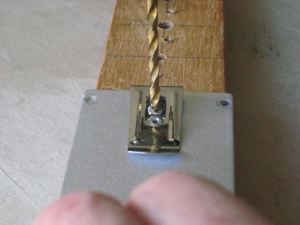

Drill out the rivets of the hanging clip
I also removed the hanging clip from the backplate so I could use the plate as a template for drilling the holes in the heatsink.

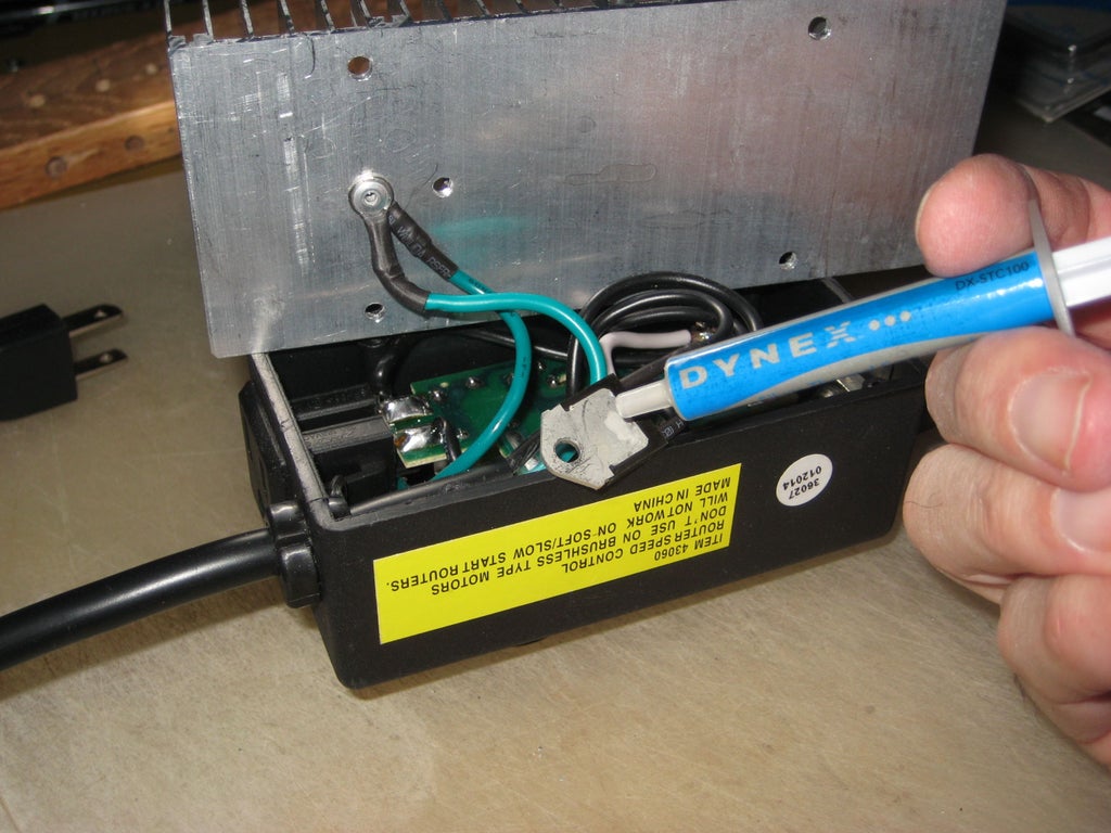

Triac
Apply a generous quantity of heatsink compound to the back of the triac package.
Carefully position the triac so the holes line up.
Push down on it to start spreading the paste, and then tighten the screw firmly, but not too tight, or you could crack the plastic triac case. The paste will spread out very thinly, which is what you want--just enough to fill any gaps while maintaining as thin a layer as possible. I tapped the hole with the closest tap I had. It was off by about 1 TPI but I was able to get a good firm connection. You will have to determine the best tap to use from what you have on hand.
