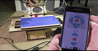

This Instructable will show you how to set up a Raspberry Pi-based print server so you can control and monitor your 3D printer remotely (including remote slicing) from a phone, tablet, or computer.
Wireless Printing
Of course, the main purpose of this Instructable is to show you how to build a print server that will allow you to untether your 3D printer from your computer. You will be able to launch prints directly from your phone, no computer required.
Remote Printer Control
By the time you complete this tutorial, you will be able to control your 3D printer remotely, from a phone, tablet, or remote computer. The AstroPrint software we will be using allows you to move your printer, extrude filament, adjust extruder and bed temperature, and actuate the fans.

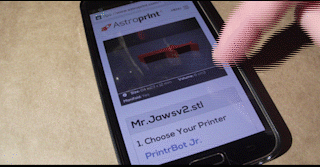

Cloud Slicing
The most powerful feature of AstroPrint, and the one that sets it apart from other software, is the AstroPrint cloud slicing service. With other similar software, like OctoPrint, on which AstroPrint is based, you still need a computer with slicing software to prepare 3D printing files. The 3D print server we will build in this Instructable will allow you to go from STL 3D models, to launching print jobs, without any need for a computer at all. You can do everything from your phone.

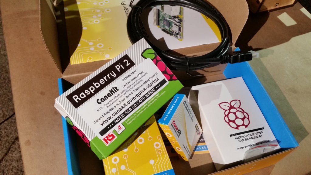

Step 1: Gather Your Parts
We will need some parts to build our 3D print server.
To build your own 3D print server you are going to need a few parts. The table below lists all of the parts needed for this build. In the left-most column of the table, I've identified each part with a number. Below the table are some notes about each part corresponding to the numbers in the table.
The total cost for this project is about $85. If you have Amazon Prime you will not even need to pay for shipping.
Aside from the parts in the table below, you will obviously need a 3D printer. Back up to the previous step for an explanation of 3D printer compatibility with AstroPrint.
Parts List
Reference NumberImagePartQuantityLink
1Raspberry Pi 2 Complete Starter Kit1Amazon
2Edimax EW-7811Un Wi-Fi USB Adapter1Amazon
3Micro SD to SD Card Adapter1Amazon
Part Notes
1 This Raspberry Pi starter kit is a convenient way to get all of the Raspberry Pi-related parts you will need for this build: a Raspberry Pi board, a power supply, a Raspberry Pi enclosure, and a micro SD card. Note that this kit does include a WiFi module, but it is, unfortunately, not supported by AstroPrint at the time of this writing. This kit also includes an HDMI cable which is not necessary for this build, but it is useful to have for debugging purposes.
2 This WiFi module is extremely popular for use with the Raspberry Pi. It is also the only module currently supported by AstroPrint. This is a concurrent mode WiFi adapter, meaning it can connect to your home WiFi network and act as a WiFi hotspot which will allow devices to talk to your printer locally and over the internet.
3 The Raspberry Pi 2 uses a micro SD card to hold the operating system (image). So, you will need some kind of adapter so you can plug the micro SD card into your computer and install the image onto the card. If you have a regular SD card reader on your computer, you can get this Micro SD to SD card adapter. Alternatively, you can get a micro SD to USB adapter.

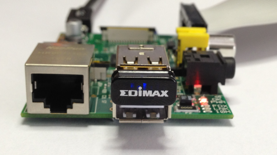

Plug in WiFi Adapter
The 3D print server we are building communicates with other devices over WiFi. As mentioned in the first step of this Instructable, the Edimax EW-7811Un is capable of connecting to your home WiFi network and acting as a WiFi hotspot.
It does not matter which USB port you choose for the WiFi adapter, simply pick one and plug the WiFi adapter into the Raspberry Pi.

Wherever your model came from, it will end up in your AstroPrint File Manager for your AstroBox. So, from the AstroPrint Dashboard, navigate to your Raspberry Pi AstroBox by tapping the Monitor button. You should find your RaspberryPi AstroBox listed on the page. Select Camera/Control. Finally, on the next screen, select the launch button.
This will bring you to the Dashboard for your AstroBox. Open the File Manager. You should find a list of whatever models you uploaded, as well as an AstroKey.stl file, which is the AstroPrint logo that was automatically placed in your File Manager.
You can launch a 3D print by tapping the 3D printer logo next to whatever model you want to print. When you press the print button you will be taken to a page where you can monitor the progress of your print.
