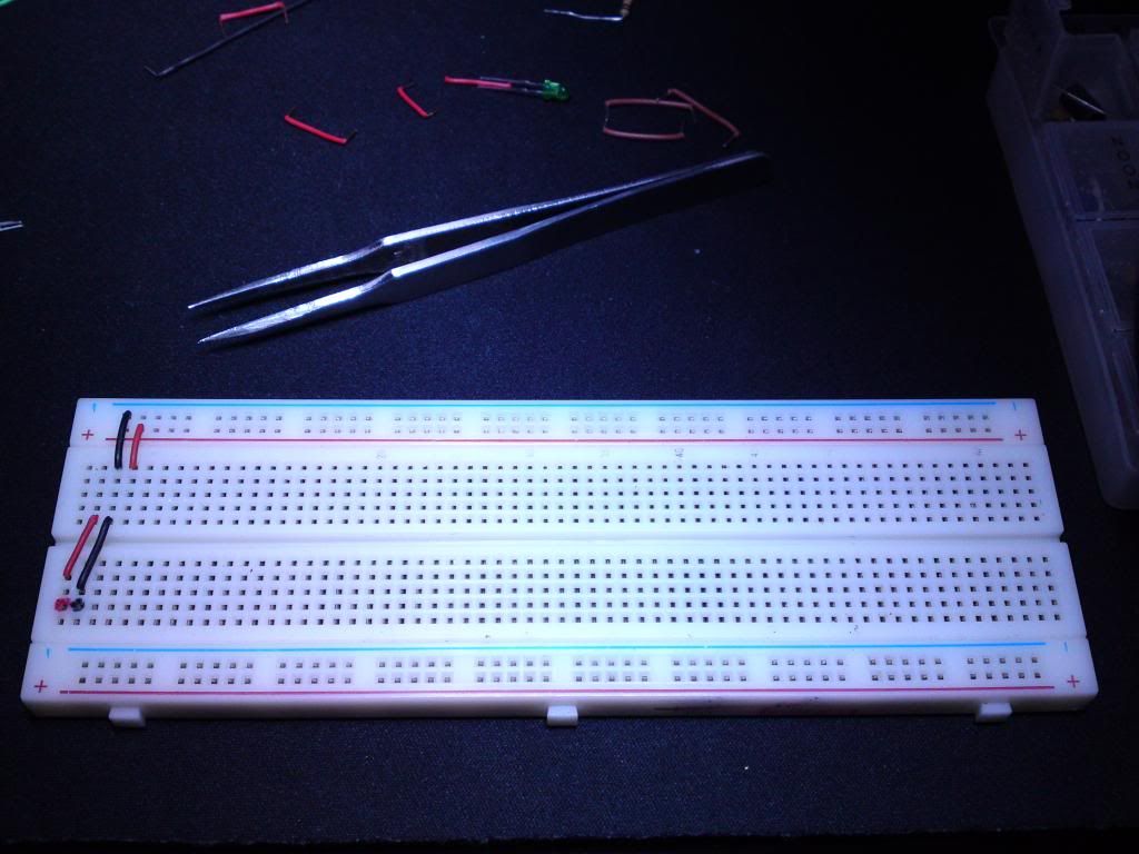

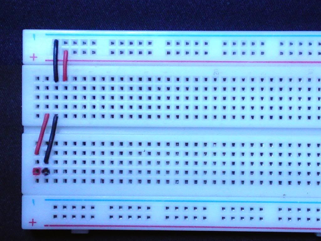

Step 1: Step 1 - the Power Supply
1st of all, Try to Keep the BLACK & RED Power wires as the same colours as in this Guide because this just makes it easier to see very clearly & quickly if a wrong connection has been made so that it will further aid you in troubleshooting later, in case something was inserted incorrectly, but this breadboard setup has been thoroughly tested and has been tripple to quadruple-checked and then checked once more because overkill is so under-rated & for peace of my mind lol !
Look at the pics below, left and right, start by inserting the RED & BLACK power lines exactly as shown:

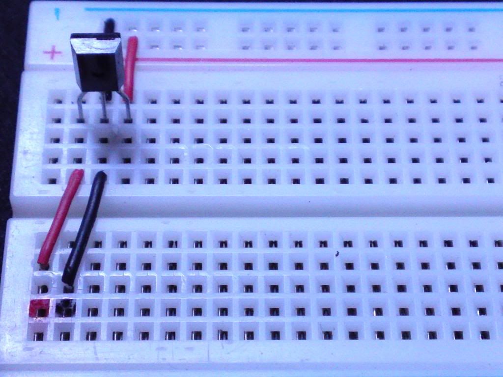

Also See that ive marked the breadboard holes with my sharpie pens - Where the INPUTVOLTAGE wires will need to get inserted into - so whether you are using a battery pack or mains DC Voltage, this is where it would need to enter, use only the RECOMMENDED 9v to 12v of input voltage as this will NEVER put a strain on the voltage regulator !

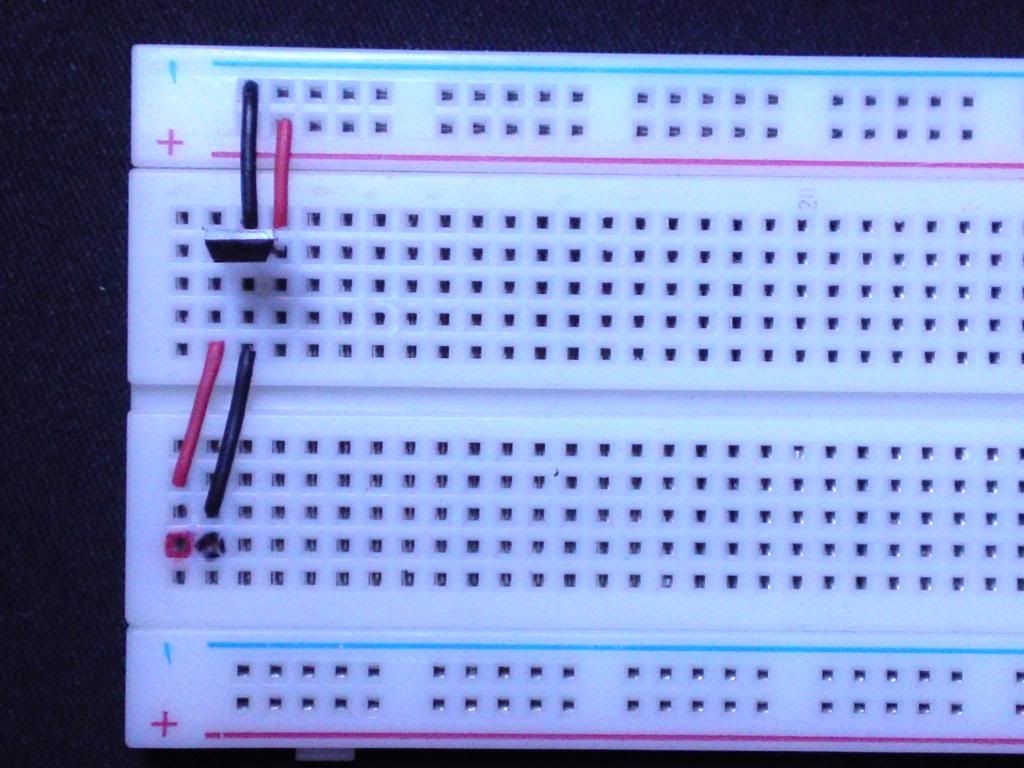

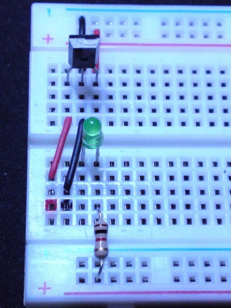

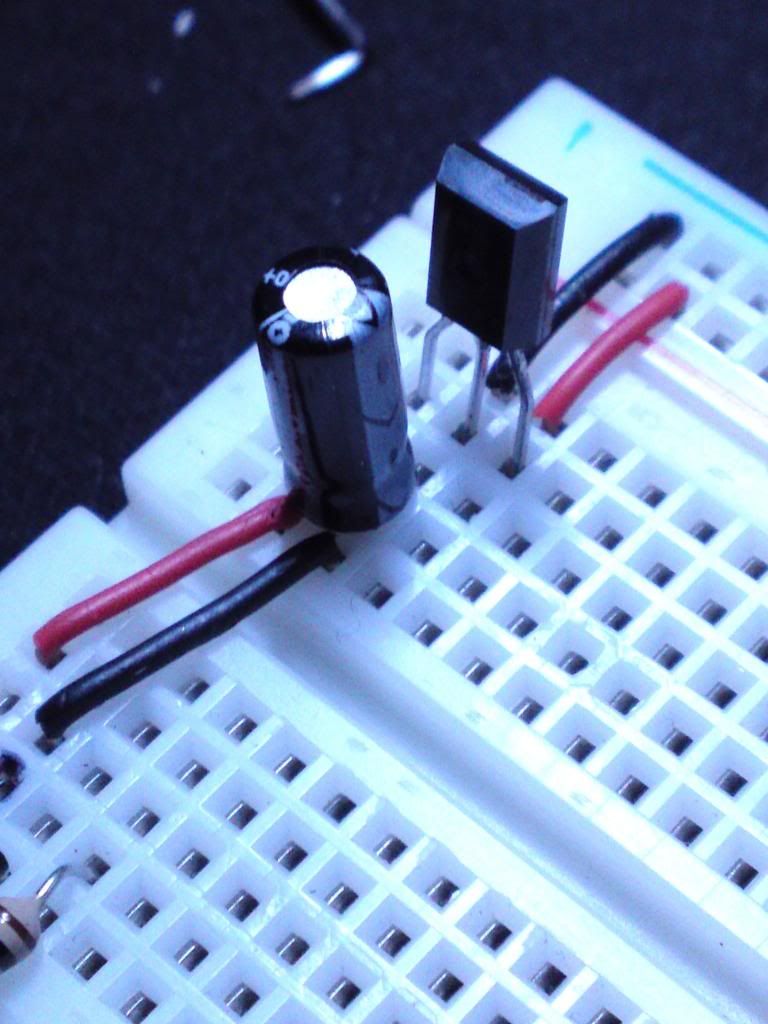

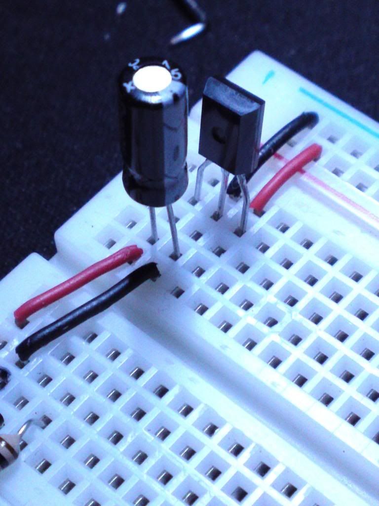

Now follow the next pics below, add the 5v Voltage Regulator, this one is a Low Power Version, Perfect for battery operated projects!
Looking at the regulator as its sitting in the breadboard in the below pics, from left to right the pins are:
INPUT --- GND --- OUTPUT

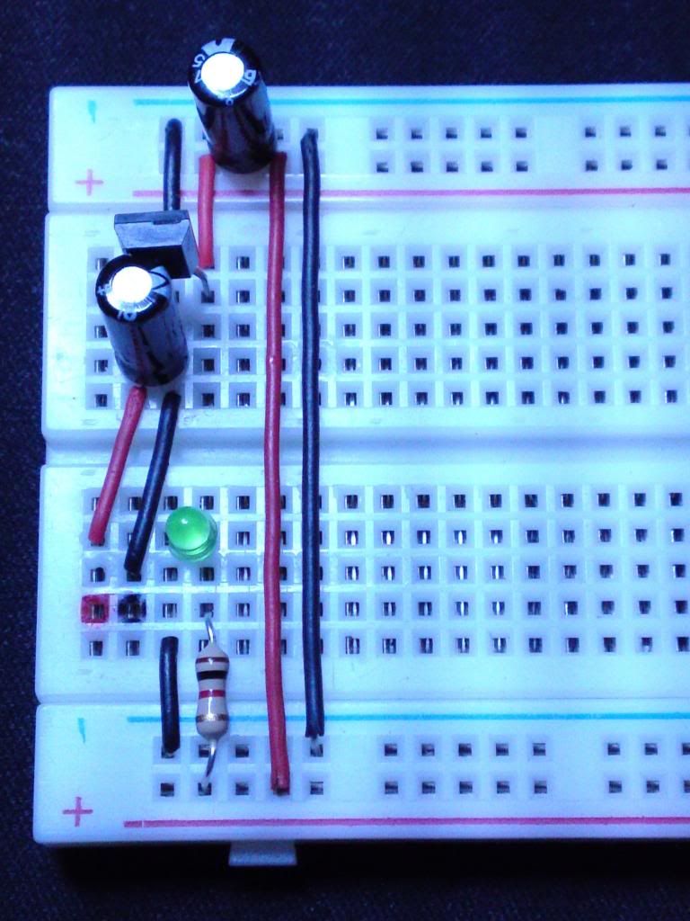

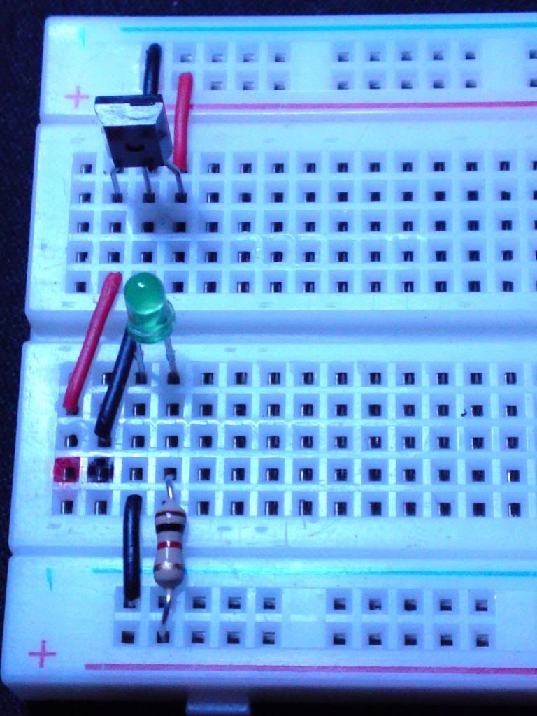

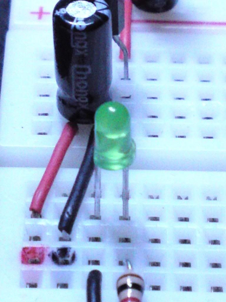

Now to add the Green Power LED, its 1K Resistor and the BLACK Wire going to the GND rail on the breadboard:
The Lower left pic is showing that there is the flat notch on the LED, that is the NEGATIVE side of the LED so this will need to be placed as shown and the pic on the Lower right is showing the addition of two wires, RED & BLACK connecting the upper and lower power rails of the breadboard together:

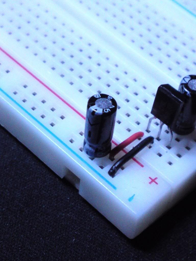

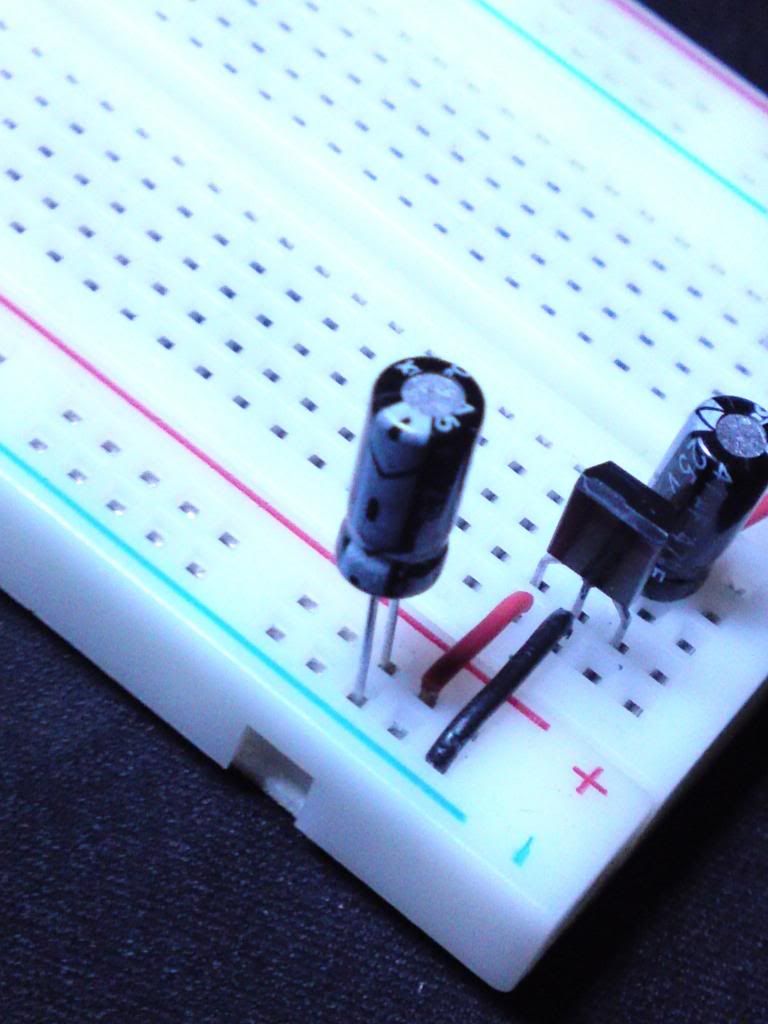

Next Add the 1st Electrolytic Capacitor making DOUBLE SURE that the NEGATIVE Side is actually going into the NEGATIVE power rail of the breadboard or capacitors could EXPLODE so do make sure this is checked over a few times lol ! I'll start by placing the Cap (Capacitor!) at the back of the Voltage regulator so these two pics below are from a different angle:
All Cap's have a dotted line (Dashes Actually, if you wanna nit-pick lol) going down the side of the NEGATIVE Lead section on their bodies so just look out for that as & when your inserting them! Also at this time i'll point out that i like to cut all components leads as short as possible, just so that they will sit flush with the breadboard so they dont ever get accidentally yanked-out by a stray wire being hooked up to any of the connection pins later when prototyping !

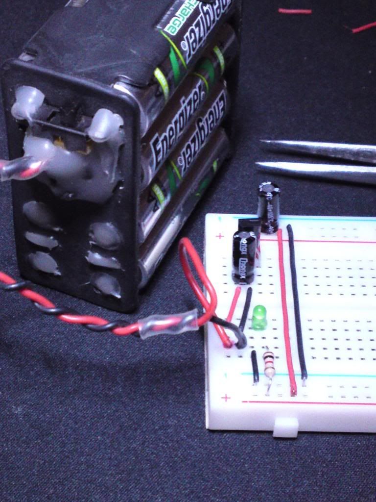

& Now for the Front Cap:

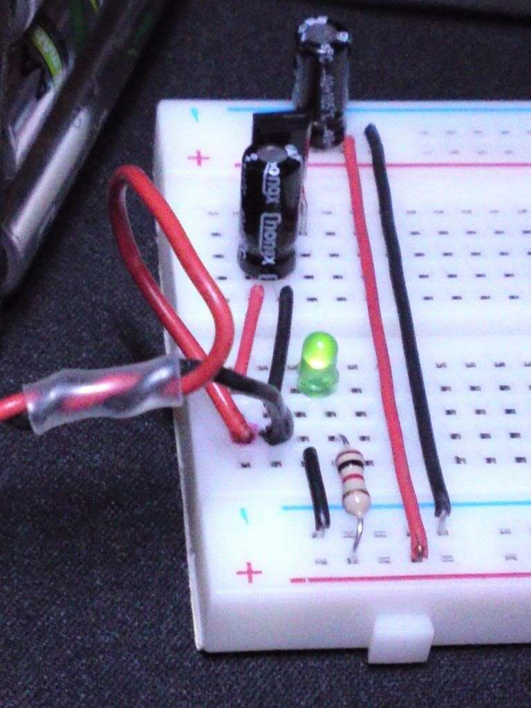

Now your breadboard should look like this, below:

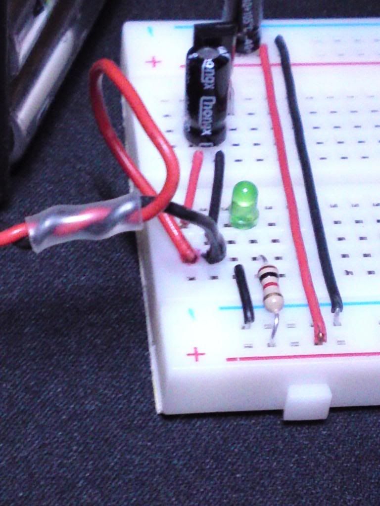

Now you should just give everything a quick check to make sure it is all correct as now we will test this power section, i will do this by adding a battery-pack to the INPUT holes on the breadboard that i had marked with a RED & BLACK sharpie earlier:
I have also added a SPST Switch to my battery pack, the same battery pack used in my 1st instructable of the Arduino UNO on Breadboard (the Breduino, lol !) so that i can hook everything up, re-check everything is good and when im happy with it all, flip the switch and the Green Status LED Should light up but at this point use your DMM (Digital Multimeter) to make sure that the OUTPUT pin of the voltage regulator is definitely giving out 5v or very close to 5v !
Now you have a Working Power Section !
