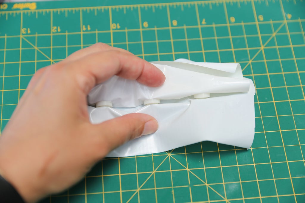

Step 11: Printing on Heat-Sealable Fabric
Printing on heat-sealable fabric is even easier than printing on a perforated fabric. This is because the step of printing before laying the fabric down is not necessary. The filament bonds to the polymer coating on the fabric. The TPU bonded beautifully and created a very strong connection. However, when I used PLA it did not bond with the polymer well enough to use in the future.
Tape down the fabric onto the platform and adjust the height of the platform a smidge to compensate for the thickness. Load your print and hit go! The print stays really well on the 30 denier nylon I link to in this 'ible from Seattle fabrics.
