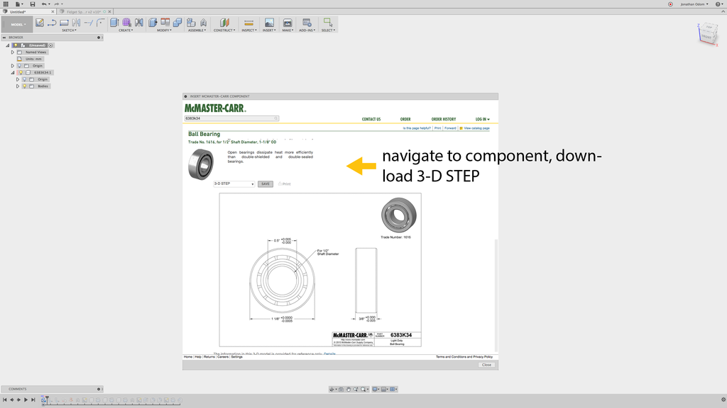

Fist, you'll need to insert a 3D model of the bearing you're going to use make the spinner. Fusion has a McMaster-Carr part insertion feature that makes it super easy to work with super accurate 3D models of parts you can order from them. McMaster is a vast resource for manufacturing and making in general. They sell everything from plastic sheets to conveyor belts, and for many machine parts (and pretty much every fastener) they have 3D models that work as though they were made in Fusion.
To insert the part, go to INSERT>Insert McMaster-Carr Component.
The MsMaster-Carr browser will come up. The categories can be pretty overwhelming at first, but just remember that bearings are found under Power Transmission. The I used is a 1/2" shaft open bearing that costs about $8. You could make this with just about any bearing you like. If you want to use this one, you can avoid browsing altogether and just type "6383K34" in the search field at the top, and the bearing I used will come up.
Select "3-D STEP" under the file type menu, then click Save.
Fusion will then create a new component with the part number as the name. This makes it easier for you to order the right parts when you're ready.

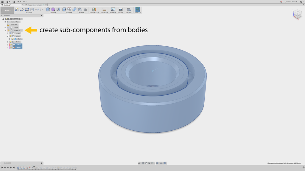

The part will come in as a component with a series of bodies in it. I want to simulate the movement of the mechanical joint within this part so I can see how my spinner will move, so I'm going to need to make some sub-components.
First, I right-click on the the component and select Activate from the drop-down menu. Next, I expand the Bodies in the activated component, then select each body to highlight them in the canvas. This way, I can find the two components I need- the inner ring of the bearing and the outer ring. When I find these, I right-click on them and Create Components from Bodies. This will give me two new sub-components.

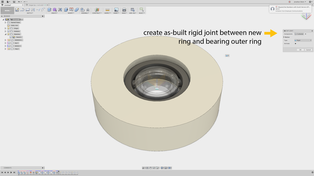

Step 5: Create Rigid Joint
Since you've already got your revolute joint (on your bearing sub-components), you just need to create a rigid joint between the new ring and the outer bearing ring. Go to Assemble>As-Built Joint again, select these two components, and select Rigid as your joint type. This will make it so that if you click and drag the ring, it will spin along with the bearing.

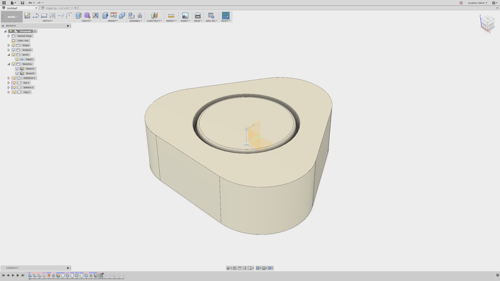

Step 6: Create New Profile
This spinner will work just fine as is, but I've decided to give it a new profile to make it more fun. I made three big circles using Polar Array in the Sketch menu to create the profile, but you can use any shape you like. The piece will still spin as long as the new shape is radially symmetrical.
Try making a polygon shape by selecting SKETCH>Polygon>Inscribed Polygon, for example. You can change the number of sides and make an octagonal profile if you want.
When you've finished your profile, go to CREATE>Extrude and select the profiles you want to use to cut.
My spinner now has a rounded triangular profile.

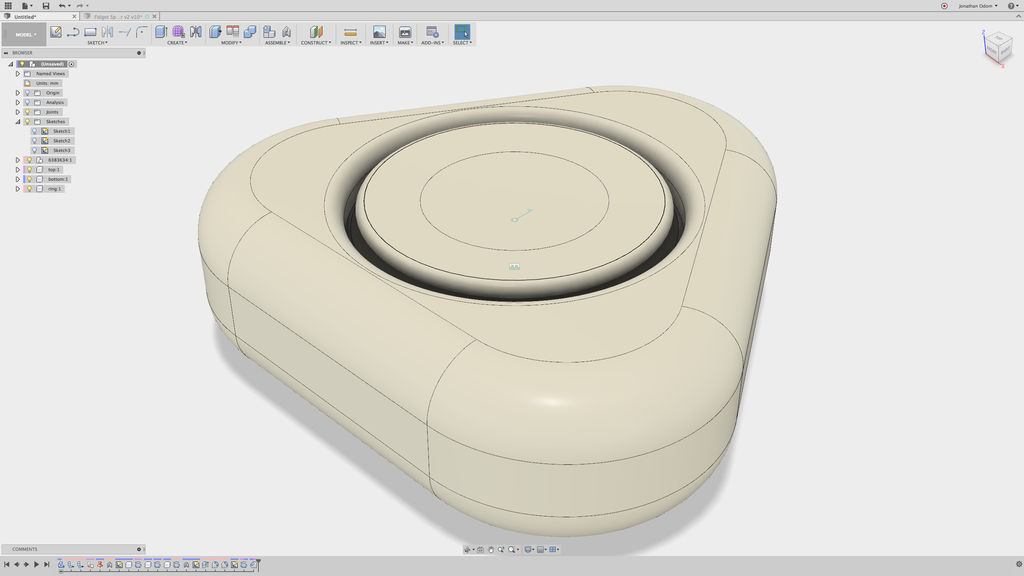

To make it more attractive and smoother to the touch, I go to MODIFY>Fillet to round off the edges of the ring.

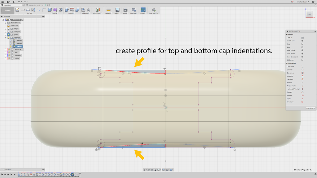

To make the part even more comfortable, I added some indentations to the caps. To do this, I create another sketch on one of the vertical origin planes, then go to SKETCH>Project / Include>Intersect and select the two cap bodies to give me some lines to work from. I draw tangent lines from the circles I added at the ends of the profile, then go to SKETCH>Fillet to make a nice smooth profile.
To cut this shape out of the caps, I go to CREATE>Revolve, select the profiles, then select the centerline as the axis. This should Cut the shape by default, which is what I want.
With the Section Analysis turned on, you can now see the finger indentations and the new triangular profile in cross-section.

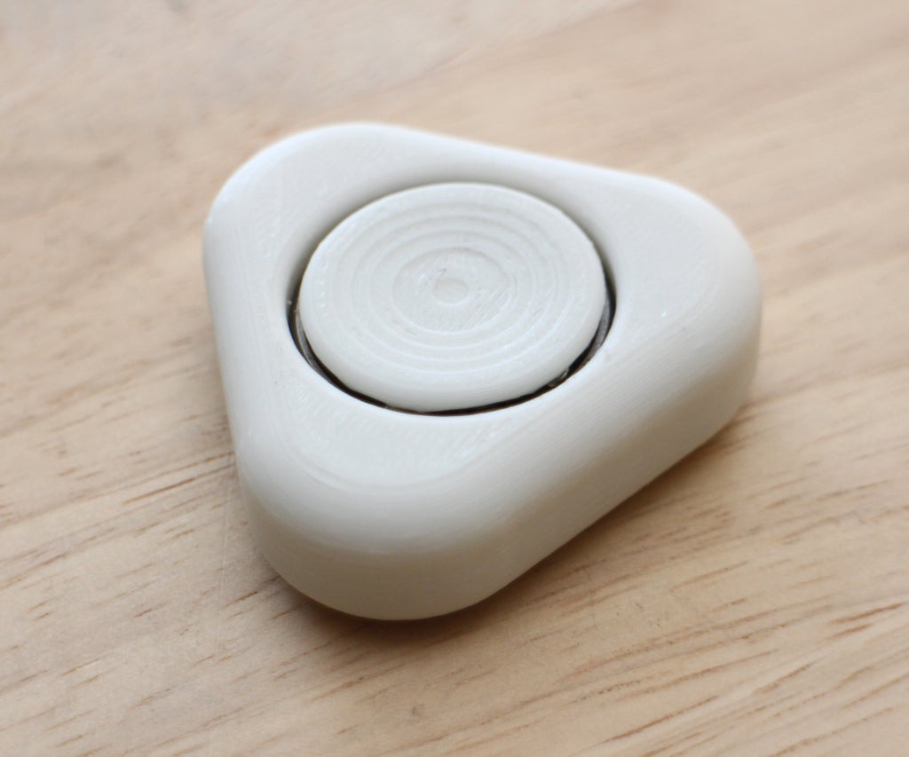

Step 10: Assemble and Fidget
The assembly is really straight forward. The bearing is symmetrical, so it can be inserted with either side up (you may need a hammer to tap it in). Be sure you're inserting the correct caps in the top and bottom- the thinner one goes on the bottom to make room for the ledge.
The gradual slope of the indentations on the caps create this stepping effect- this could be avoided with a steeper slope, but the look of this doesn't bother me.
It's a very satisfying action, and it feels comfortable in my hand. The denser the infill, the heavier it'll be, and the longer it'll spin. Have fun!
