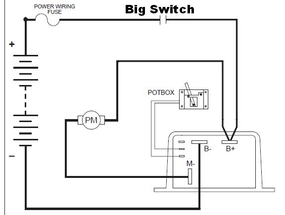

The only other 'major' component is the Main Contactor. It's an electronic 'throw-switch' that connects all of that battery power to the Controller. It is key-switch activated and runs on 12 volts. (I wired it into the Ignition fuse.) I also have it wired in series with the kickstand switch so that after you turn the key-switch you can only drive away with the kickstand up.
Dragan, You can use just a big switch. It has to be rated for the load that you expect, but a simple 'blade-switch' (like they used in the Franekstein movies) works just fine. But there is a safety issue... that's a lot of volts exposed you know...

instead of having a main contactor, could I simply use a big switch?
and plug everything as on this diagram?
http://img24.xooimage.com/files/6/7/a/diagram-f856d8.jpg
