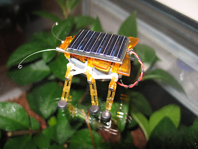

pagosapig5 years ago
Good design-I like how you used the gears
Personally I like this leg control design better---
1.bp.blogspot.com/_gUN424lfLOQ/SSLW7zqVfCI/AAAAAAAAAJ0/Apc6U1qcPbc/s400/HexBug+Mod+04.jpg
