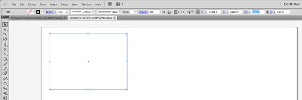

Open up a new file in Adobe Illustrator, I chose the file size to be 18" x 24" because that is the bed size of TechShop's Epilog Helix laser cutters. It also helps visualize where and roughly what size the cut will be by putting it in context with the bed.
Draw a rectangle with rounded edges (it is one of the basic shapes in the dropdown menu if you click and hold (or right click) on the shape tool. While the shape is still selected, specify the dimensions in the toolbar at the top of the screen. THIS IS IMPORTANT: Add an extra .25" to each dimension to give yourself enough room to stitch the leather to a nice snug fit.

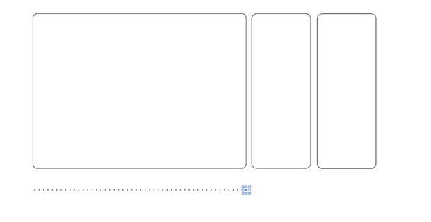

First, draw a circle with a width of 0.02" anywhere on the page (it helps to be far away enough from the previously drawn rectangles that they are not accidentally selected during this procedure). Select the circle and Transform>move. Type in a distance of 0.15" @ 0 degrees and then press the "COPY" button instead of "OK"
Now, with the new circle still selected, type Ctrl+D to Transform Again. This should add another circle .15" to the right. Repeat this command until you have a line of circles that is about 7.25" long. The intention being that you now have a string of holes long enough to span the top of the large rectangle.

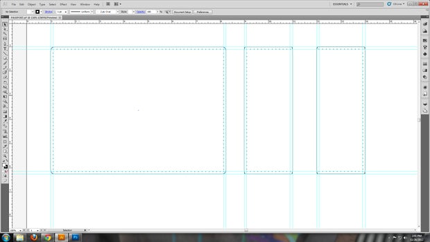

Create guides for and locate the two side panels as well so that we can easily make offset guides for holes later. I've also copied and pasted a few lines of holes to rotate and move around for the next step.
Now that we know exactly where the outlines are, we can create guides for the holes. Create two new guides (one horizontal and one vertical) that are offset .1" from the ones you just drew.
Select an entire row of holes and drag to place centered on the .1" offset guides for the larger rectangle. Copy, paste, and rotate in order to achieve holes all the way around this first shape. Delete any holes that are unnecessary. Your spacing will be slightly off in the corners, but it will not be noticeable in the end. The result should look like this:
In order to get holes that match up on the inside flaps, click and drag a selection box around the area where the left flap will be placed (remembering that the flap is 2").  You may have caught a few things that you don't want to copy when drawing this selection box. You can always remove items from your selection by pressing shift and clicking the unwanted items to deselect. Items such as guides and the larger rectangle  will need to be deselected so that when you do perform a copy, you are only getting the hole pattern. Paste the pattern and drag it to line up with offset guides on one of the smaller rectangles (flaps). Since one flap goes on each side, do the same thing for the other small rectangle, but this time be sure to select the pattern on the right side of the large rectangle instead of the left, because that is where it will eventually be attached.
You should end up with something that ends up like this:

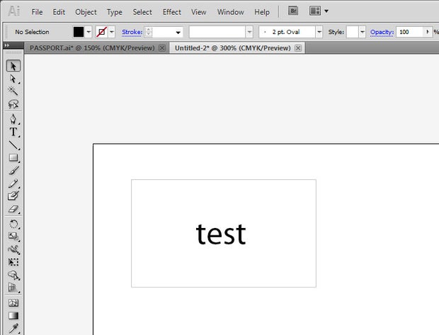

I always like to run a few test cuts and etches to make sure my settings are dialed in before I send my file. These typically consist of one cut and one raster, like this:
I run the same test a few times until I am satisfied with the cut quality. After doing this, be sure to write down your settings so that if you plan to recreate the cut, you have a better approximation of where to start.
