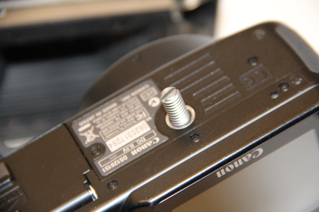

Begin by taking the lens off your Canon Rebel and the rear cover off the KVP (make sure there isn't any film in there!). Next, screw in the headless screws into the tripod holes on the bottom of the cameras. They have been using the same size tripod holes since tripods were invented!
