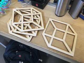

I tiled the shape and cut it out 30 times out of 1/8" thick plywood such that this operation could be completed from a single sheet of 2' × 3' plywood (the bed size of the Epilog cutter I was using). Stack them and sand/brush off any ash residue.
I made extras so I could have some funky coasters (thanks Trent for this tip):
