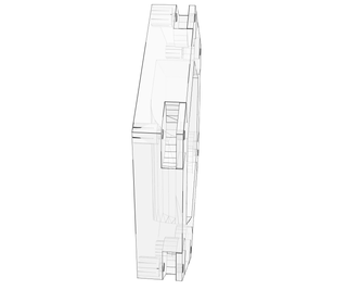

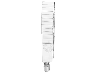

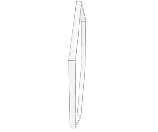

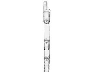

This jig was designed in 123D Design beta. Step 3 pic shows a drawing of the arm. Pic 2 shows a closeup.
Each arm is printed as one self assembled piece (arm.stl). The conical pins hold the hinges together even without the screws.
