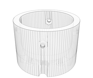

Step 2: Design
Mocking it up
As soon as the OPY1 tubes were in, we (ofcourse) slapped on some LEDs right away to check out the light dispersion effect. We just grabbed any lightsource we could find, from phones to ceiling lamps and held our tube up against it, and it was glorious! While it wasnt as bright as we had maybe hoped, the effect is amazing. But we never intended to use scotch tape or a breadboard as structural elements in our design, so we got cracking on designing a 3D printed holder for the LEDs and tubes so we could suspend them from the ceiling.
Fusion 360
We used a really neat software package from AutoDesk, called Fusion 360. Fusion is very powerful software, and is free to use for hobbyists. And while there are easier to master tools on the market, you cant beat its functionality at this price level.
A first version of an end-cap was modeled that could hold the lightsource in place against the end of the tubes (at that time we were using AdaFruit's crazy powerful Pixie LEDs). The holder doubles as a clamp onto a three wire cable that provides the LEDs with a power, ground and signal line... but also acts as a wire to suspend the lamps from.

Improvements!
But even with all the care in the world, first prototypes are never perfect, and neither was our first design. The caps were undersized, the holes for the bolts needed extra drilling to ensure a good screw-bite and the clamping cap was misaligned, giving it a very messy look. We also needed a bit more space inside the enclosure to stash the excess cables. So it was back to the drawing board for us! Aside from everything that didn't work, a lot of things did... and its just really great to hold your design in your hands and look at it up close.
Step 4: Iteration
Iteration and redesign is the key to good design. Four versions of the enclosure and a number of different LED configurations were tried and printed before we finally arrived at a final working construction.

Construction
Also the construction of our 3d printed endcaps was improved over a number of design iterations. The first versions held on to the OPY1 tubes using glue, making repairs virtually impossible. Later iterations included captive nuts as metal inserts for screws and setscrews that hold the OPY1 tubes in place. Mating pins were added to ensure correct alignment of the halves and the overall dimensions were changed. The kind people at Plug'nmake in Delft printed out a neat final version of the caps for us.
Print it yourself
The final STL files are attached if you´d like to print them out yourself. You will have to do some light drilling of the holes for the clamping screws, also you will have to drill a hole for the neopixel wires to pass from the front to the back of the main body. The M3 nuts used as metal inserts were pressed in using a soldering iron and superglued for extra strength. Depending on your printer tolerances this may or not be nessecary.
