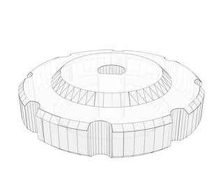

The treads where printed using one of the Objets more interesting features, the ability to print combinations of separate types of materials at the same time. The light blue areas of track are mostly a rigid white material with a pinch of rubbery black. This gives the print a solid structure with just enough flex to be snapped together. The rubber treads are more rubber than rigid, making an outer surface that gets much better traction than its light blue counterpart. Since the two materials are printed together they are permanently bonded.When it came time to make this hub for the track I tried to build around my initial tread design, but the geometry just wouldn't work out. I ended up starting from scratch by drawing a hub first and a track made to fit around it. The new parts were printed out, assembled and tested. Happily, the mechanics flowed like they were made for each other! I tweaked the tolerances by .05 mm or so and printed a few dozen links.

Tread Set includes files for a single segment of tread, a drive single hub, and a free spinning hub. Since each piece of track is the same, more copies of the track segment are printed to make the entire length. The drive hub is designed to fit on a the end of a small gear head motor, but could certainly be modified to fit other types. The free spin hub is made to fitted with an axle and simply roll along with the track.
