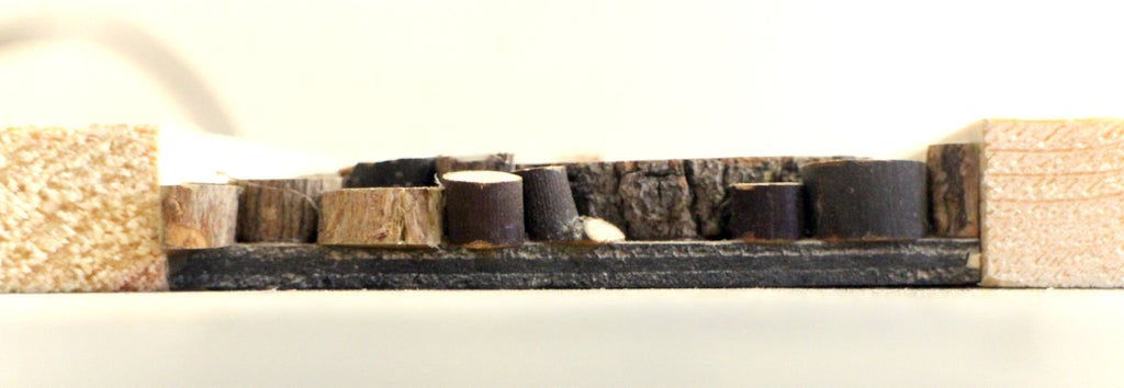

The router sled will ride on rails over the piece to be planed down. The rail heights need to be parallel, in line with the work, and taller than the highest part of the work so the sled can glide over.
Hot glue is used to hold down the rails and work, which makes a sturdy lateral bond that is easily broken when lifted upwards. This is perfect for our needs.
Small dabs of hot glue were attached along the bottom of the rails and they were adhered directly to the workbench. There needs to be room on either side of the work that is going to be planed to allow for chips to go when planing. Missing this step will result in your planing area getting clogged, or spitting chips all over the place (which will happen anyway - this is just makes it much worse). I usually leave about a finger's width on either side.
The rails need to be taller than the highest point of the piece you want to plane. Use straight, flat, and square stock to make the rails. This will make your planing life much easier than using warped wood, which will yield an inconsistent result.
Above, the two rails are taller than the work to be planed down, allowing the router sled to pass over top without obstruction. The rails will need to be moved away from the work to allow for chip collection, this image is just for illustrative purposes.

With the rails established (either on the workbench on on the work-piece), the sled needs to be able to slide from one side to the other without falling off the rails.
Before starting any planing, and without turning the router on, slide the router across the rails and check that the sled is long enough to transverse the rails and there's no obvious obstructions to gliding the sled across and down the rails.
