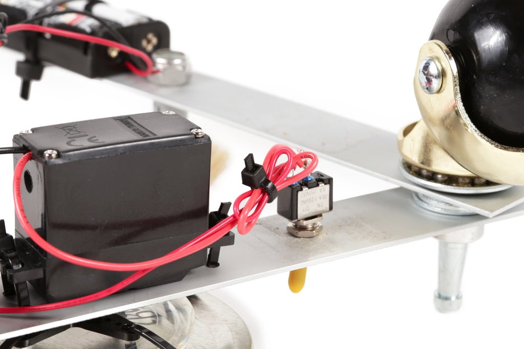

Step 9: Mark and Drill the Ruler Again
Position the servo motor atop the ruler such that the shaft is centered inside of the 1/2" hole and the servo's longer end is pointing towards the pre-existing hole at the end of the ruler.
Mark the servo's mounting holes upon the surface of the ruler. It is easy to double check your measurements for this because a ruler practically measures itself.
Once all four holes are marked, drill them with a 1/8" drill bit.

Step 13: Attach the Servo
Insert the servo's motor shaft through the 1/2" hole.
Zip tie it in place using the servo's mounting holes and the aligned holes on the ruler.
Trim away the excess zip tie tails.
Finally, firmly reattach the servo horn using its mounting screw.

Step 21: Insert the Switch
Insert the switch into the 1/4" hole from below and fasten it firmly in place using its mounting nut.
Step 22: Wire the Switch
Solder the red wire from the motor to one of the metal terminals on the underside of the switch.
Solder the red wire from the battery pack next to the motor to other terminal on the switch.
