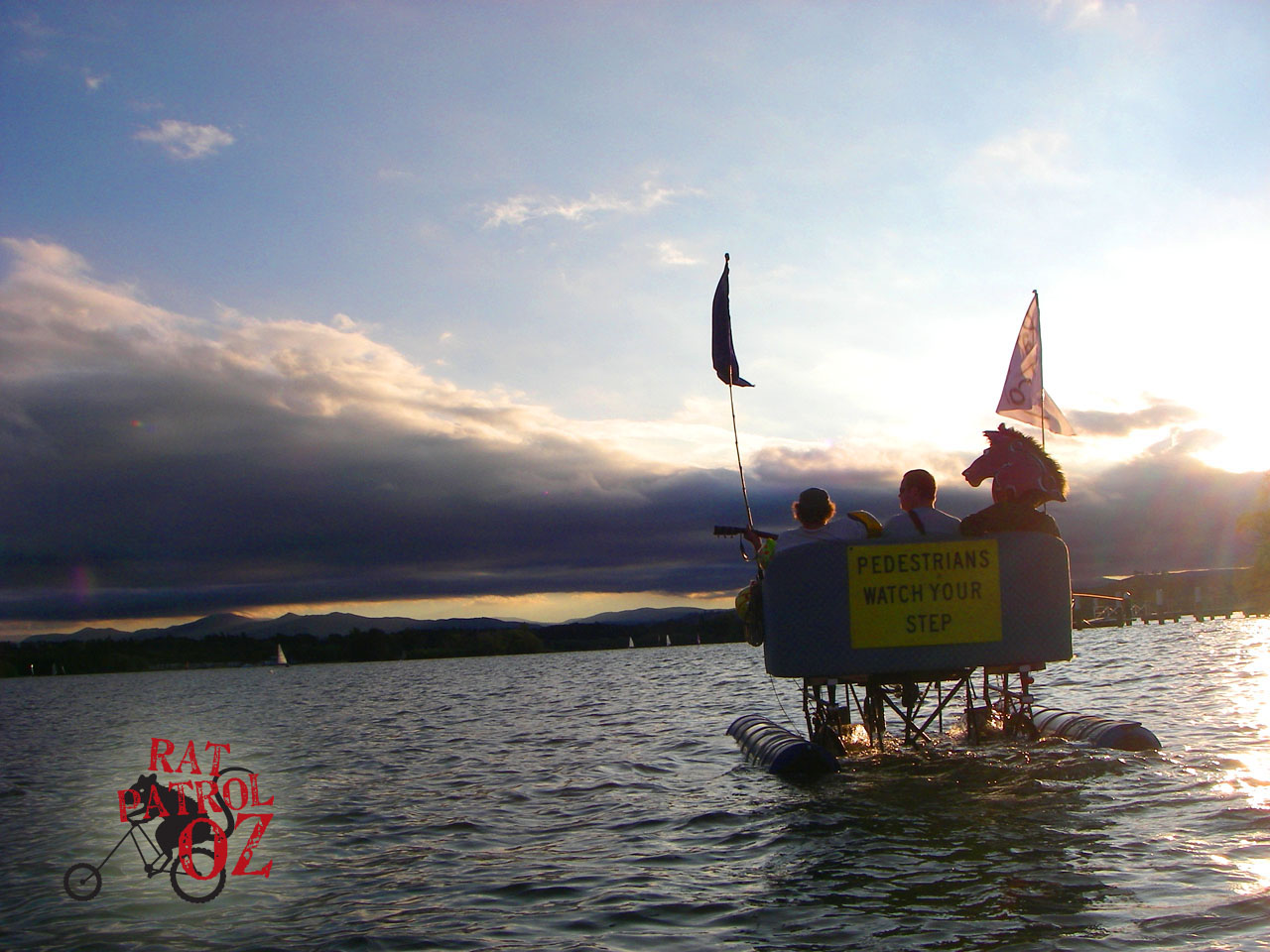

Step 4: Floatation & beer
Floatation was quite an issue. It had to float yes, and while it would be OK if things dropped off here and there, it HAD to be UNSINKABLE. You know what they say about the dangers of mixing beer and water...
I figured (hoped) about 300 litres would be fine... I cut the bottom out of the plastic barrels, scuffed the joining surface, then after they had been sitting in hot sun for a while, a few of us smashed them together using epoxy resin and a huge piece of wood... of course, beer played it's part too :)
All of a sudden, the whole structure was totally rigid — wow, it worked really well!! Next we drilled a 10cm dia hole in the side of the barrels, close to the end. So now we had bulkheads, which were filled with expanding polyurethane foam. Bomber.
Next, I used angle iron to make the float base, which had nylon strapping going through lugs to attach the floats. So far so very good.

Finally it was time to ride this thing into the water (dry photo showing floatation barrels prior to strapping)... I was only guessing the placement of the barrels and wondered about it's stability in the water.
Funny thing is... IT WORKED PERFECTLY THE FIRST TIME!!!!!!!!! Didn't expect that. Mmmmm, beer, the sweet taste of success :)
Step 7: Living the dream
OK, it probably has a top speed in the water of about 1 knot, but it's a STYLISH ride! The cops aren't sure how to take this one, it's a bike but it's much bigger than a car... or is it a boat? We are quietly confident that she is legal in this country.
