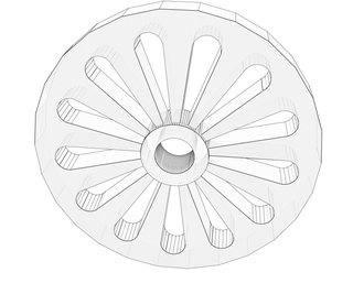

Step 2: Design the Wheel
For designing this Wheel Cypher, I will be using Google’s Sketchup 8 on a Windows 7 computer.
My 3D printer requires .STL files or .OBJ files. Sketchup 8 does not support these file types. But, there is a Plugin available that can create .STL files.
Here are links to the software packages that I am using here:
Sketchup: http://www.sketchup.com/
Sketchup PlugIn to Export STL files: http://extensions.sketchup.com/en/content/sketchu...
First, Open Sketchup and select the template for designing. Our printer reads everything in millimeter (mm) measurements. If we design an object as 2”, the printer reads this as 2mm. So, we need to develop everything in mm. In Sketchup, we choose the “Product Design and Woodworking – Millimeters” template.
Per Thomas Jefferson’s description, we want the finished cylinder to be 2 inches in diameter and 6 to 8 inches in length. So, our first step is draw a circle of 2 inches in diameter. To assist us with aligning the letters, we’ll draw it with 26 sides to create the full alphabet on one ring.
To get a 2” diameter, we use the circle tool. Click on the origin, move the mouse out some distance and then click again. This will draw a circle. To set the radius of the circle, you can now just type in the desired radius. In this case, we’ll type “25.4” and hit ENTER. (1 inch radius * 25.4mm/inch) To create the 26 sides, we type in “26s” and hit ENTER.
Instead of boring an axle hole through, we get to design the axle hole into ours. For this design, I have decided to use a ¼” threaded rod for the axle and use knobs on the ends to tighten down. This design will allow us to tighten down the wheels to keep them from moving while we are looking for the message. To create our hole, we draw a circle of radius 3.5mm. A 1/4 inch rod would actually have a radius of 3.18mm, but we want the wheels to slide on easily so I chose a radius of 3.5mm. We don’t need this circle to be 26 sided, so I type in “100s” to make it more like a true circle.
To keep the wheels from rubbing fully against each other, I have decided to add a “hub” extension on one side of the wheel to separate it by 1mm from the next wheel. To create this, I add a circle with a radius of 6mm. We don’t need to type “100s” this time, Sketchup will use the last setting used.
Now we want to make our wheel thickness. Using the Push/Pull tool, select the biggest wheel surface and pull it up some distance. Type “6” and press . This will create a thickness of 6mm, or roughly 1/6 inch, as suggested by Thomas Jefferson. Next, grab the hub ring with the Push/Pull tool and pull it up 7mm. This will create the hub extension 1mm beyond the disc surface. At this point, Sketchup still has a surface in the center of the wheel. To remove this, simply click on the surface and press DELETE .
We now have a basic wheel. In fact, if you made the outer ring 100 sided instead of 26 sided, you could use this for building a toy car.
At this point, we could export this as STL and print it. But, it isn’t really visually appealing. So, let’s add some decoration.
Step 3: Make It Pretty
I have decided that I will make spokes to decorate this.
To do this, I invert the image by using the orbit tool so that I can work on the same plane that has the origin point. Since there is an even number of segments, I can draw lines between the points on the outer ring to an opposite point and that line will go through the origin point. I draw all of these lines, creating pie slices.
For this wheel, I have decided that I want a 3mm "Rim". So, from the origin point, I draw a circle with a radius of 22.4mm. (25.4mm - 3mm) I could delete out every other spoke at this point, but I think it would look nicer if it had rounded edges at the rim. To do this, I create another circle from the origin with a radius of 19.4mm. (3mm from the last circle.) To create the rounded spoke, I use the arc tool; click on an intersection of a spoke line with the 19.4mm radius circle, then click on the next spoke line that intersects with the 19.4mm circle. Using the mouse, I then pull the arc until it reaches the 22.4mm radius circle. See the picture of how it looks at this point.
Next, using the pointer, select each of the line segments that make up the 19.4mm radius circle and the 22.4mm radius circle and delete them. These were just guides and are no longer needed. We also delete the lines from the arcs to the outer edge, the lines from the outer edge of the hub to the origin point, and the surface that got re-created over the axle whole. Again, see the pictures to see how this looks without the guide lines.
Using the Push/Pull tool, push in each spoke hole 6mm to create the spokes.
That's it!
Save the file as .SKP, which is the native file type for Sketchup. We’ll want this format if we decide to modify this design later. To be able to print, though, we’ll need to export this as .STL. Export the file by selecting “Export STL…” from the File Menu. In the popup menu, select the units to be Millimeters and leave the file format as Binary.
This part is now ready to take to the printer.
