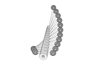

Twist one way and this toy turns shows a slow spiral pattern. Spin it the other way and you get a very different stairstepping pattern. It's all a matter of playing with angles of rotation. Thanks to parametric design and 3D printing it's a quick path from idea to reality.

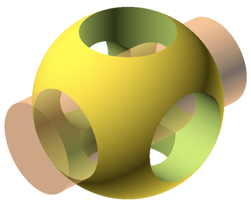

OpenSCAD is a horribly ugly little program that can do wonderful things if you like thinking in arrays and loops. The process of learning it takes a couple hours, but it's free and worth the time. Here's a quick overview of how I got into it.

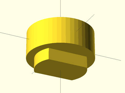

On the bottom a rounded rectangle is added. In OpenSCAD this means intersecting a cylinder with a box.
intersection(){
cylinder(h=ballHeight, r=connectorWidth/2-2, $fn=50); cube(size=[20,8,ballHeight], center=true); }
The intersection function returns a shape that is where the two more shapes intersect. Here you can see the result of a rectangular solid (a "cube" in OpenSCAD) and a cylinder intersecting.

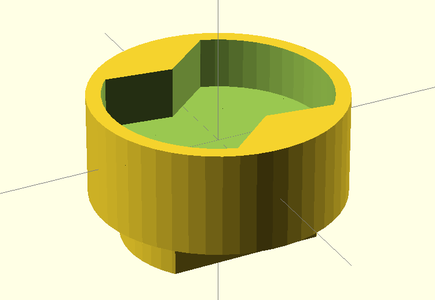

Step 5: Make an Indentation
To make the indentation is to repeat the extrusion process a couple of times and later use the difference function to remove it from the connector.
The only change to each rectangle here is a rotation function. There is the -8 rotation in the first piece and a 40 degree rotation in the second.
//first group allows for 8 degree twist one way
translate([0,0,ballHeight/2-indent+margin/2]) intersection(){ cylinder(h=ballHeight+1, r=connectorWidth/2-1, $fn=50); rotate([0,0,-8]) cube(size=[20,8,10], center=true); } //second group allows 40 degree twist other way translate([0,0,ballHeight/2-indent+margin/2]) intersection(){ cylinder(h=ballHeight+1, r=connectorWidth/2-1, $fn=50); rotate([0,0,40]) cube(size=[20,8,10], center=true); }
Getting a little more complicated here, but all that's happening is that the same shape as in the last step is being recreated with the intersection of the cylinder and the rectangular solid. This is done twice with a rotation applied to the rectangular solid.
Both of these shapes are then removed from the connector with the difference function (seen later on).

spinners=8; //how many bars spinning
startDist=20; //initial distance for spinner. Minimum of (ballWidth+connectorWidth)/2 distStep=5; //increment in distance for each spinner rotatePreview=8; //preview rotation effects ballWidth=14; //width of balls on each spinner ballHeight=6; //height of balls on each spinner connectorWidth=17; //width of connector in middle of spinner indent=3.5; //depth of indentation in connector extrude=3; //depth of extrusion from connector margin=1; //extra height between balls
module spinner(dist){ //central holder for dowel difference(){ //main section union(){ //cylinder translate([0,0,-(ballHeight+margin)/2]) cylinder(h=ballHeight+margin, r=connectorWidth/2, $fn=50); //bar cube(size=[dist*2,4,3], center=true); //balls on ends translate([dist,0,0]) scale([1,1,ballHeight/ballWidth]) sphere(r=ballWidth/2, $fn=50); translate([-dist,0,0]) scale([1,1,ballHeight/ballWidth]) sphere(r=ballWidth/2, $fn=50); //male connector translate([0,0,-(ballHeight+margin)/2-extrude]) intersection(){ cylinder(h=ballHeight, r=connectorWidth/2-2, $fn=50); cube(size=[20,8,10], center=true); } } //indented space on top //first group allows for 8 degree twist one way translate([0,0,ballHeight/2-indent+margin/2]) intersection(){ cylinder(h=ballHeight+1, r=connectorWidth/2-1, $fn=50); rotate([0,0,-8]) cube(size=[20,8,10], center=true); } //second group allows 40 degree twist other way translate([0,0,ballHeight/2-indent+margin/2]) intersection(){ cylinder(h=ballHeight+1, r=connectorWidth/2-1, $fn=50); rotate([0,0,40]) cube(size=[20,8,10], center=true); } //cylinder to cut out middle for dowel translate([0,0,-25]) cylinder(h=50, r=3.2, $fn=50); } }
//top cap difference(){ union(){ //main section translate([0,0,(ballHeight+margin+extrude+3)-(ballHeight+1)/2]) cylinder(h=ballHeight+margin, r=connectorWidth/2, $fn=50); //male connector translate([0,0,(ballHeight+margin+extrude+3)-(ballHeight+margin)/2-extrude]) intersection(){ cylinder(h=ballHeight, r=connectorWidth/2-2, $fn=50); cube(size=[20,8,ballHeight], center=true); } } translate([0,0,-100]) cylinder(h=200, r=3.2, $fn=50); }
//spinners for (i = [0:spinners-1]) { translate([0,0,-i*(ballHeight+margin+extrude+3)])rotate([0,0,rotatePreview*i]) spinner(i*distStep+startDist); }
//bottom cap translate([0,0,-(ballHeight+margin+extrude+3)*spinners-3]) difference(){ //main section translate([0,0,-(ballHeight/2+1)/2]) cylinder(h=ballHeight+margin, r=connectorWidth/2, $fn=50); //indented space on top //first group allows for 8 degree twist one way translate([0,0,ballHeight/2-indent+margin/2]) intersection(){ cylinder(h=ballHeight+1, r=connectorWidth/2-1, $fn=50); rotate([0,0,-8]) cube(size=[20,8,10], center=true); } //second group allows 45 degree twist other way translate([0,0,ballHeight/2-indent+margin/2]) intersection(){ cylinder(h=ballHeight+1, r=connectorWidth/2-1, $fn=50); rotate([0,0,40]) cube(size=[20,8,10], center=true); } //dowel cutout translate([0,0,-180]) cylinder(h=200, r=3.2, $fn=50); }
