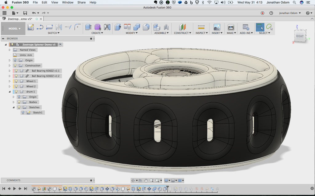

Step 4: 3D Modeling
Believe it or not, this is actually a pretty simple 3D modeling project. All it is is a drum with 12 slots in it evenly spaced, two identical wheels on the top and bottom with holes cut out to let light in, and a couple of caps and bearings. The video above shows the process step-by-step, and I'll elaborate on it below.

First, I used the Insert McMaster-Carr Component feature and brought in a couple of bearings. In this example, I used 608ZZ bearings- common bearings for fidget spinners.
I placed the bearings so that there would be enough of a gap between them to be able to see through to the animation frames- about 11mm.
I drew a profile of the top wheel and the drum in one sketch. On the right, you can see a stepped press-fit feature. I only needed half of the profile because I was planning on making the 3D parts using Revolve.
Using Revolve, I made a disc that would serve as the base for the wheels.
I made another sketch with lines patterned around the center at 120º, then offset two of those lines to make a profile that I could use as a void that would leave spokes with enough width to hold together.
I used the Extrude command to make the void.
I filleted the inside edges of the void to give the spokes a smoother transition.
I used the Modify>Pattern>Circular Pattern tool to make 3 evenly spaced voids out of the faces I just made.
I filleted the edges of the wheel to make it smoother to the touch (and to the eye) and made a copy for the bottom wheel.Using the original profile I drew, I
Using the first profile I drew, I used Revolve again to make the basic shape of the drum.
I made a new sketch for the slot shape that I would later need to cut out.
I used Extrude to make a new body that extended past the boundary of the drum shape.
I used the Pattern tool again to make 12 equally spaced bodies that I could use to cut out of the drum shape.
Using Modify > Combine, I cut the pill shapes out of the drum.
I used the Chamfer tool and Fillet tool to make raked profiles around the slots. I figured this might make the animation easier to see and it has the added bonus of using less filament.
I drew a new profile for the cap piece. The Intersect tool in the Sketch menu is helpful in ensuring that the parts will fit properly.
Using Revolve again, I made the cap.
I made a revolute joint to test out the motion with the animation frames, which I'll get to in the next step.
