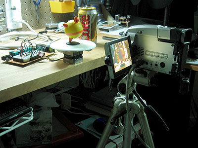

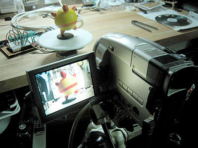

Somewhat relatedly, a few years after that, I got into microcontrollers, and processing (www.processing.org), and actually made a little turntable with a platform on a stepper motor, for perfect 1.8° incremental turning (200 steps in a full 360°). I hooked it up to a processing script through a BASIC Stamp connected via serial to the PC, and had it spin the thing, and capture a picture through a miniDV cam for each position. Then I wrote a Processing script to let me spin the object - Pom Pom, a Homestar Runner figurine. You can see the setup here:
http://www.garyfixler.com/pomspin1.jpg
http://www.garyfixler.com/pomspin2.jpg
And you can play with it here:
http://www.garyfixler.com/pomspin/
Click, and drag left and right to spin it, and if you make sure to let go inside the boundaries of the little movie, you can sort of throw him in either direction (let go while still dragging), and he'll spin, slowing to a stop.
