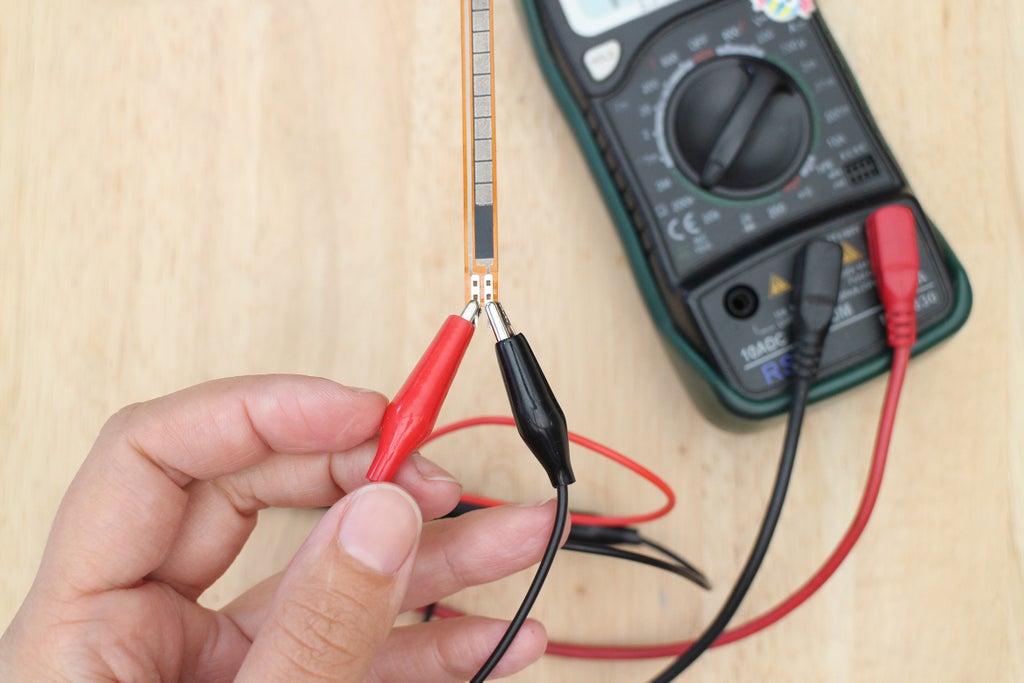

Step 2: The Flex Sensor
Remember the resistor you used to restrict current flow in your sewn circuit? The resistor used in that circuit has a fixed value of resistance that does not change. If current runs through a 47 ohm resistor it will always resist 47 ohms (+/- 5%).
A flex sensor is a kind of sensor where the resistance changes value. In other words, when current is running through it and you bend it the amount of current it resists changes. This gives you a range of values. When the flex sensor is connected to a microcontroller this range of values can be read and used as a way to sense that bending action.

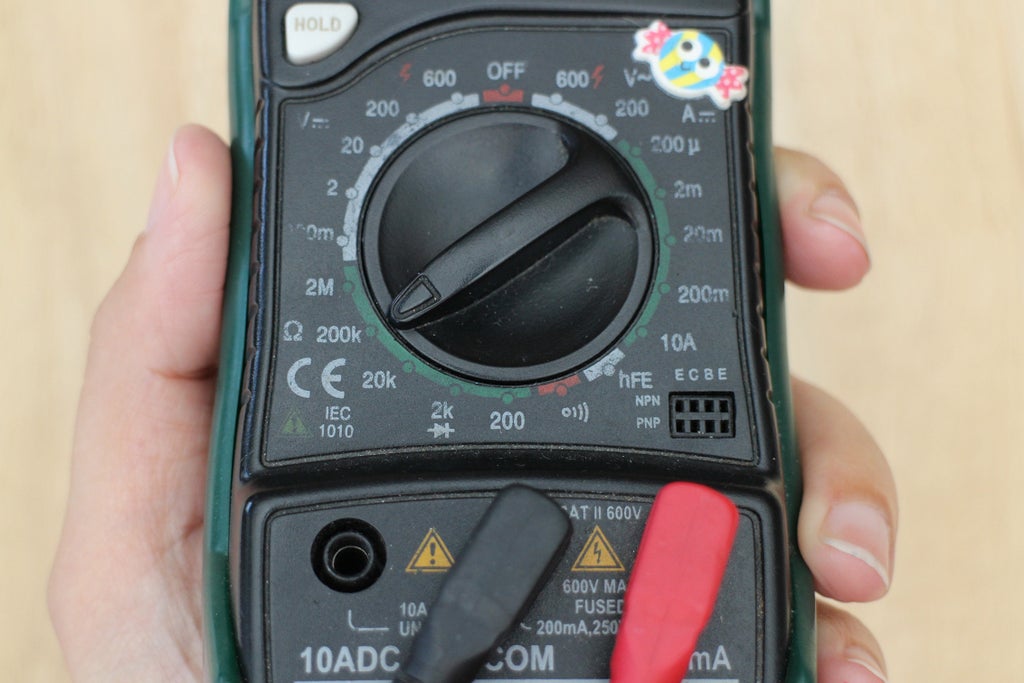

Read Changing Resistance on Multimeter
Grab some alligator leads and connect the flex sensor to the red and black probes much like how you connected a fixed sensor to it. The metal leads on the flex sensor are very close together so it may be tricky at first but you will get it eventually!
Turn the dial to 200k or any number larger than 20k on your multimeter. A number should pop up on the display screen and tell you that the flex sensor is 10k (or another resistance if you bought a different sensor than the recommended one). Bend the sensor and watch the numbers go up to about 25k. The sensor is changing based on your movements!

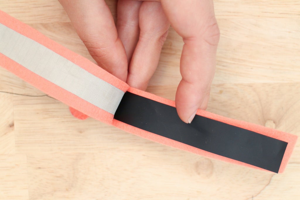

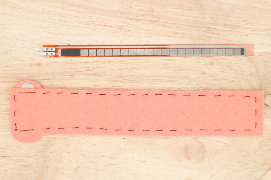

Step 3: The Handmade Flex Sensor
Take a good look at the flex sensor. It is a strip of flexible plastic that has a black and metallic design along the length of it. The black is a resistive material and the metallic part is a conductive material. This combination of resistive and conductive material is what makes its resistance change when bent. You can buy conductive and resistive materials that, when put together in the right way, can also make a flex sensor.
The materials you are going to use to make your sensor are conductive fabric and a resistive plastic called Velostat. Velostat changes resistance when force is applied, so it works as a flex sensor but it also works like a force sensing resistor (FSR) which is another resistive sensor. What's cool about a handmade sensor is that you can cut it into any shape you like. They also tend to be a bit more sensitive depending on how it's made.
There is a great instructable on how to make a flex (AKA bend) sensor by Plusea. Head over there and check out her method of making one. You can use any of the techniques and materials she uses to make yours for this class. I will also show you a way to make one in the next steps using the class materials.
Let's make a flex sensor!

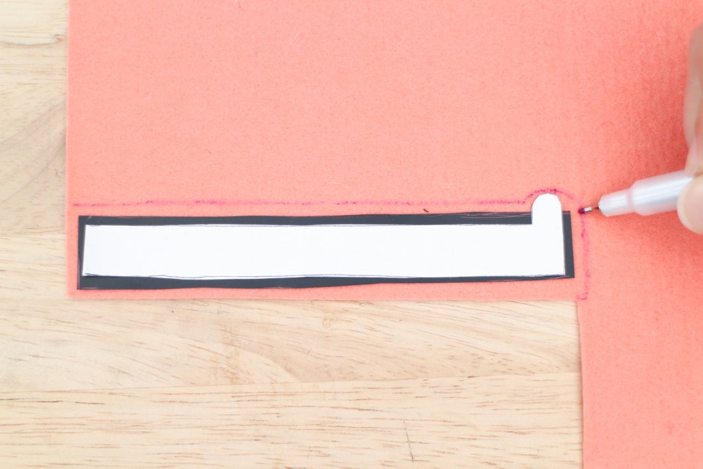

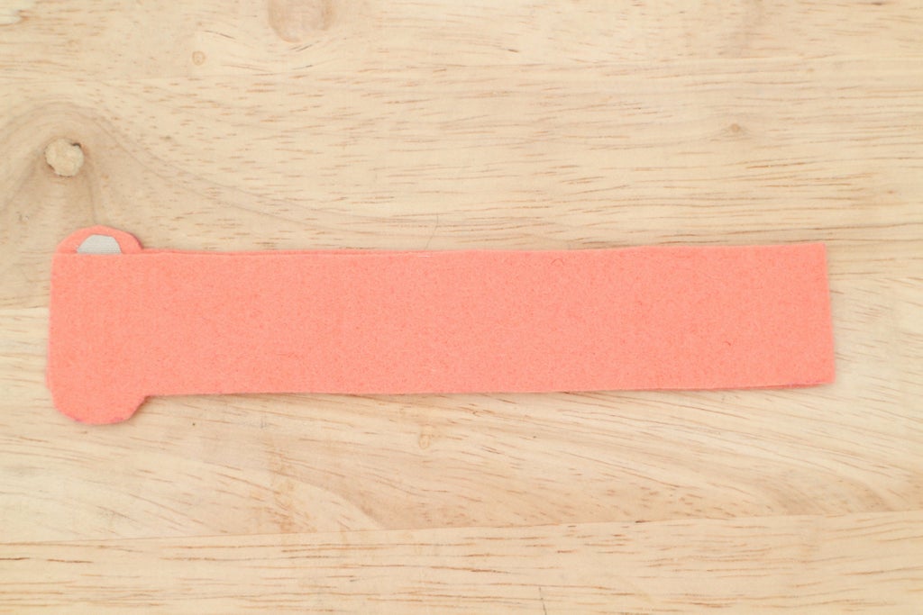

Step 6: Cut Casing and Iron

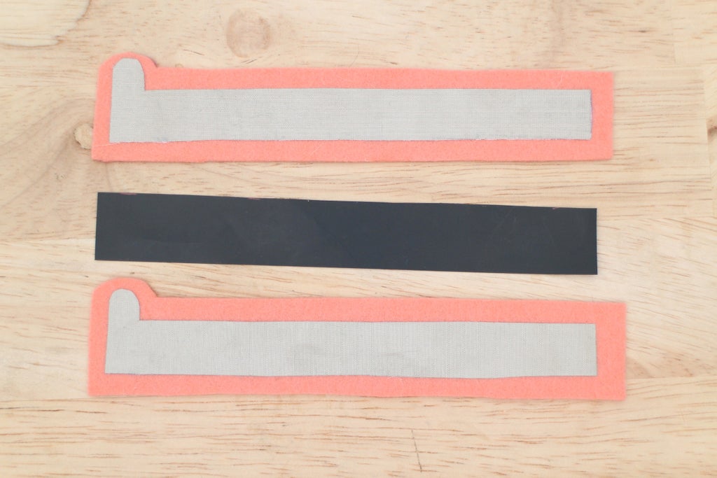

Place a conductive contact and the resistive rectangle on top of a piece of felt. With your fabric marker draw around the edges leaving a border of at least 1/8".
Cut out two casings from the felt using the same pattern. Place the conductive contacts on top and iron down.
Step 7: Sandwich and Sew
Put the Velostat in between the conductive fabric.
Thread a needle with about 18" of regular thread. Use a running stitch to sew all around the edge of the sensor. Get close to the edge of the Velostat inside but try to avoid piercing through it with your needle. Skip over each conductive fabric lead with the thread rather than sew through it.

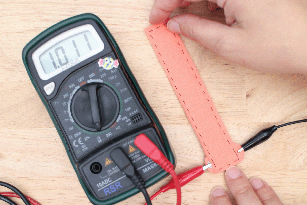

Step 8: Test
Your sensor is done! Time to test it. Connect your handmade sensor to the multimeter. Flip the dial until you get a reading. If you used the provided pattern the resistance of the sensor while it's lying still will be around 1.5k ohms. Press and bend the sensor and watch the resistance go down!
Let the sensor rest and it will rise in resistance to its maximum. Write down this max resistance, you will use it in the next step. My max reading when it is still is 1,200 (1.2k) ohms.

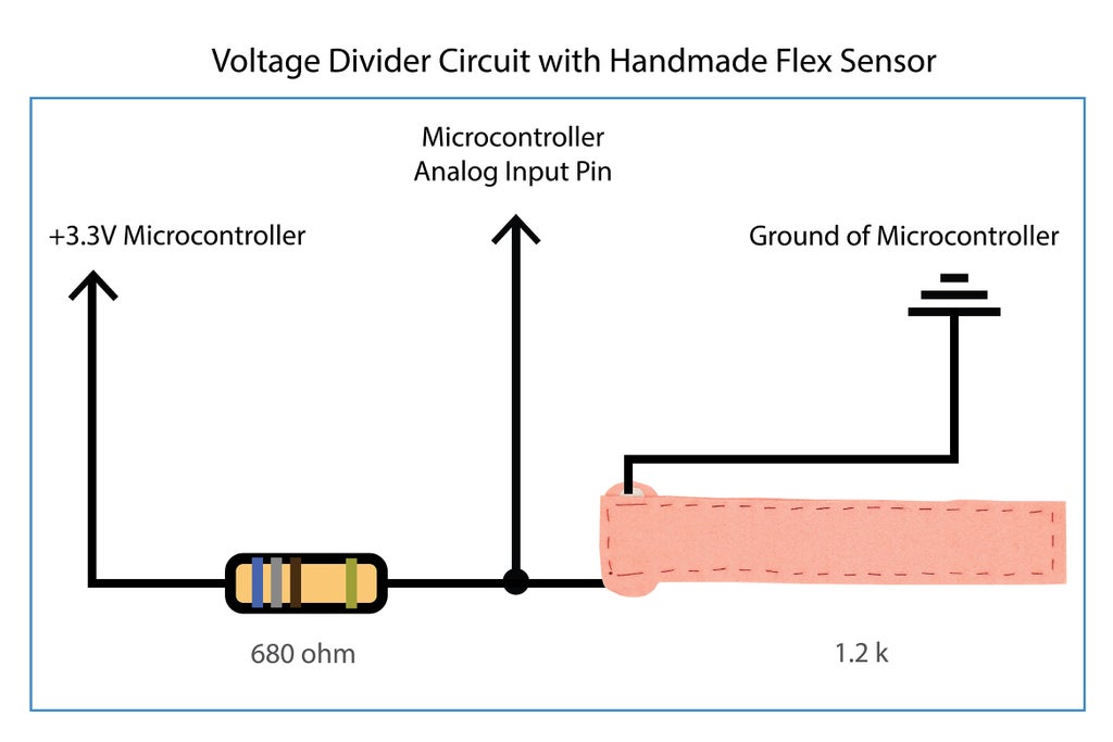

What is a Voltage Divider Circuit?
To have a microcontroller read a resistive sensor, like your flex sensor, you need a voltage divider circuit. The circuit consists of two resistors. These two resistors can either be two fixed, two variable or one variable and one fixed resistor.
The circuit we are building is the latter with one fixed (like the one you used for the sewn circuit) and one variable resistor you would like to read (the flex sensor!). You run electricity through the two resistors and take a reading from the point where the two resistors meet. When the sensor changes resistance the voltage coming from the middle point, labeled "Voltage Out" in the diagram, changes. Below is the voltage divider circuit using schematic symbols. In this diagram R1 is the fixed resistor and R2 is your sensor (variable resistor).
The value of the fixed resistor (R1) in the circuit is important because it will determine the range of voltage coming out from the "Voltage Out" point.
Choosing Your Fixed Resistor
As you learned in the Introducing Electricity lesson, there are many values of resistors to choose from. We already know R2 represents our sensor in the above diagram. How do we know what value resistor R1 should be? The value of R1 will determine the range of voltage that gets read by the microcontroller, so you shouldn't choose just any value. To get the value that is best for your sensor there is a general rule of thumb to go by. This rule is easy to remember and will ensure you get a nice large range of voltage to work with.
+ Take the max resistance of your sensor and divide it by half. This is the value of your fixed resistor.
For example, the max resistance I measured my sensor at was 1.2k ohms. I divide that by 2 to get the value of the fixed resistor.
1,200 / 2 = 600 ohms
I round up from 600 and will use a 680 ohm resistor for my voltage divider circuit. Divide the max resistance you previously recorded by two and round up to the nearest resistor value you have in your kit. What did you get?
Want to know the math behind this circuit and how it works? I won't get into it here instead, head over to Sparkfun's Voltage Dividers page to learn more and make sure to check out their nifty voltage divider calculator.
Putting it all Together
Ok, so now we have our fixed resistor value which is R1 in the diagram and we have our sensor which is R2. What about the rest of the diagram? What gets connected to what on the LilyPad USB?
Below you can see how the above diagram is applied using your two resistors and the microcontroller. The "Ground" translates to the ground on your LilyPad USB, the "Voltage In" is the 3.3V coming from the power (+) pin on the LilyPad USB and the "Voltage Out" gets connected to an analog input pin so the board can read it changing. The "Voltage In" gets divided so the "Voltage Out" will always be smaller than the "Voltage In".

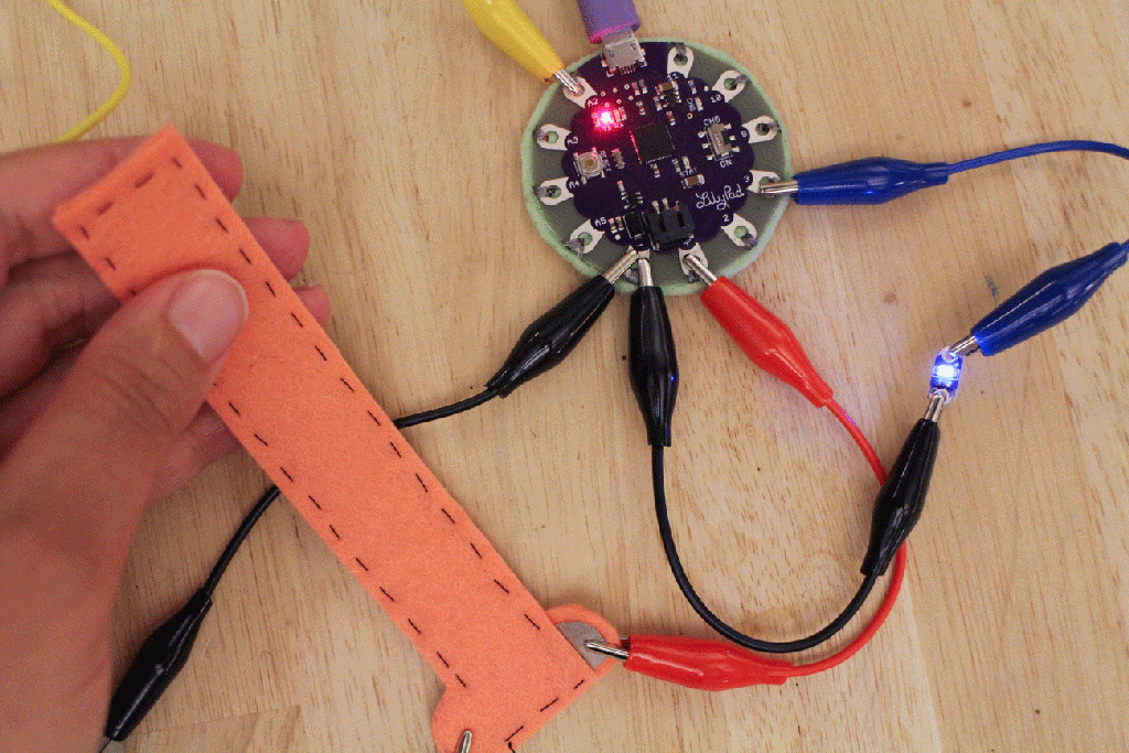

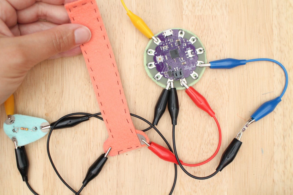

Step 10: Build Circuit
Let's read the sensor's values and add an LED as an output. This next exercise uses the sensor to fade on and off an LED. Grab your trusty alligator leads and make these connections:
flex sensor --> power (+) LilyPad
flex sensor --> resistor
resistor (same side the flex is connected to) --> pin A2 LilyPad
resistor --> ground (-) LilyPad
LED power (+) --> pin 3 LilyPad
LED ground (-) --> ground (-) LilyPad

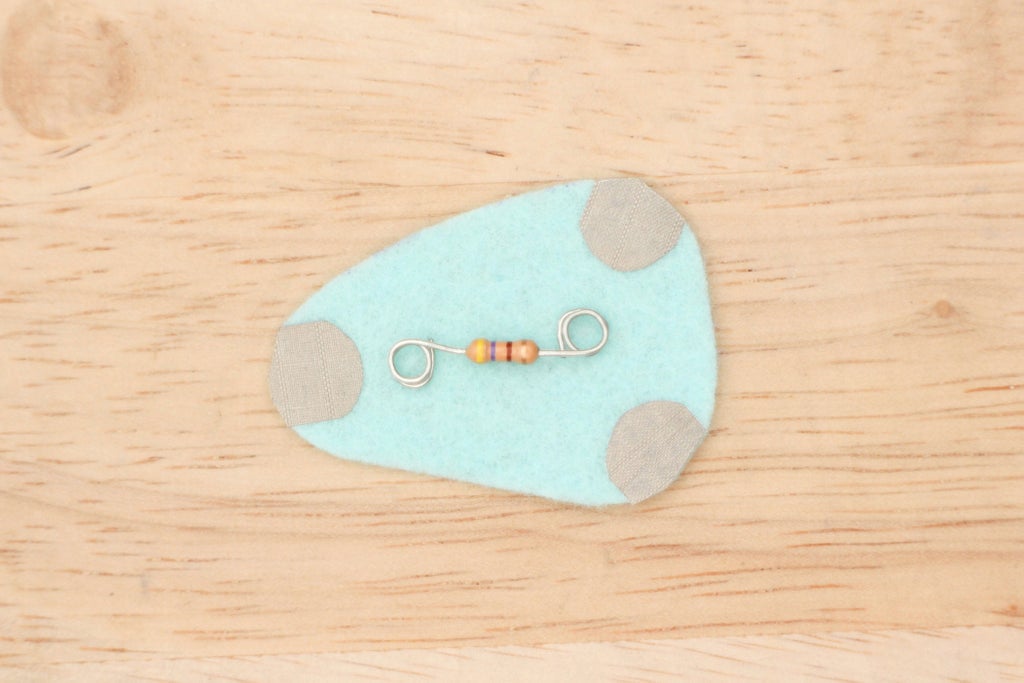

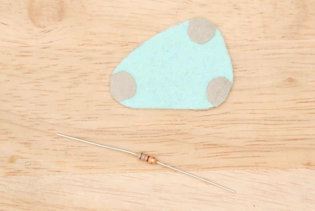

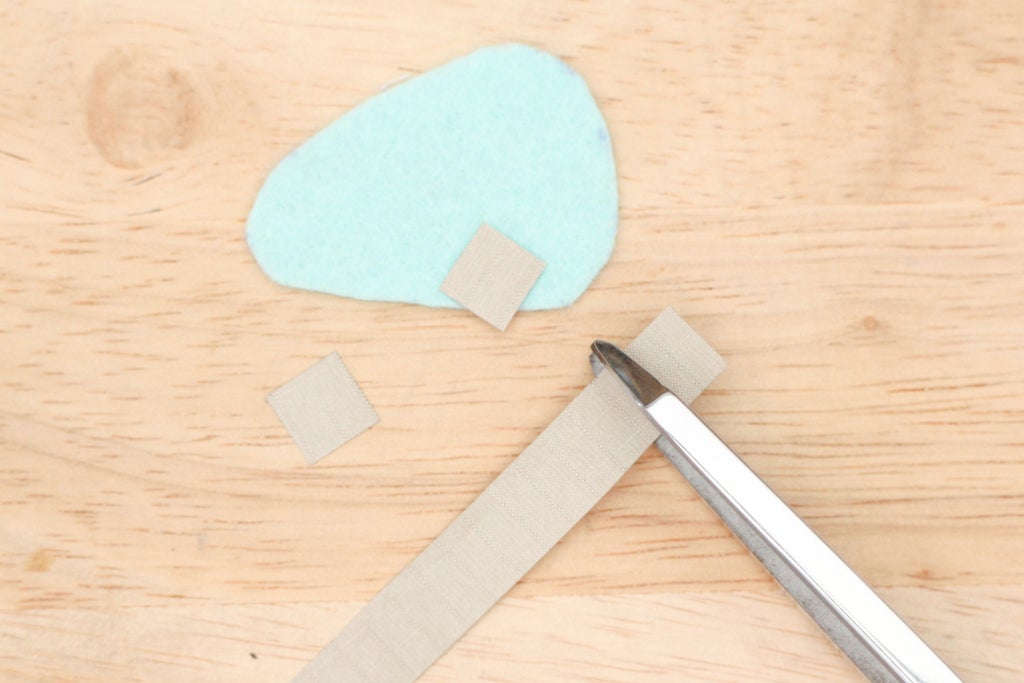

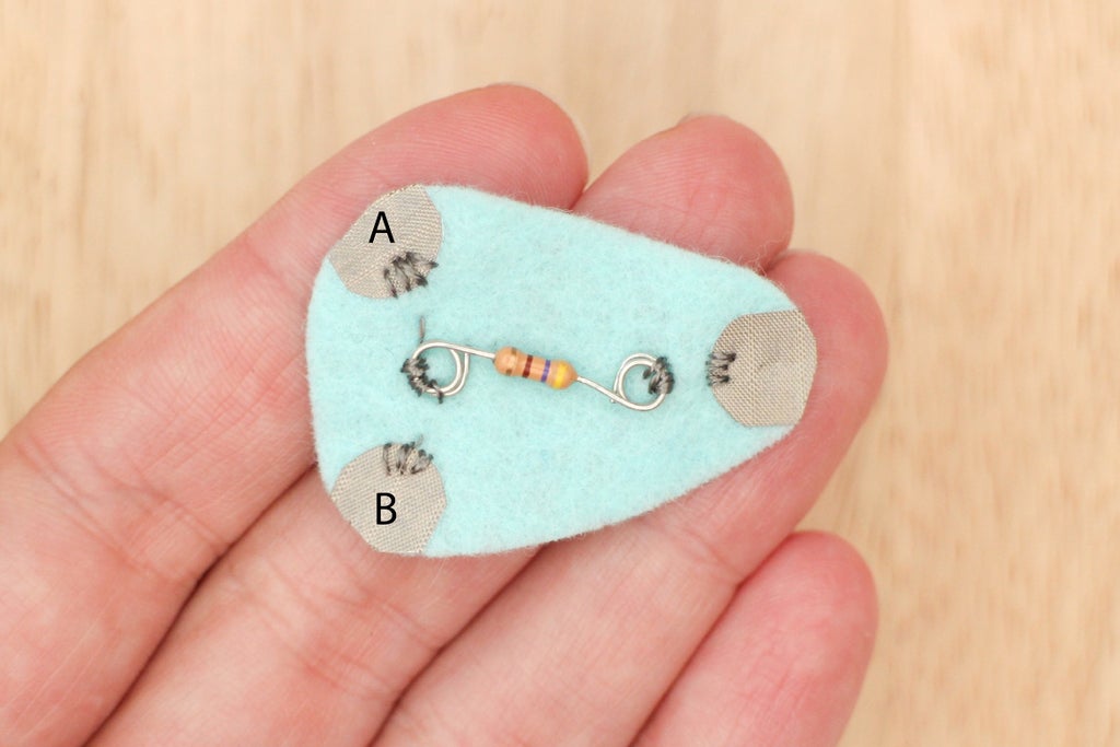

Connecting to the Resistor
You may have noticed that my 680 ohm resistor is looking a bit different. One lead of the resistor gets two connections: one to the sensor and the other to pin A2.
To make it easier to clip to I sewed the resistor to a piece of felt and to three conductive fabric pads. You do not have to make this but if you would like to, there is a pattern included in this lesson's files. Here is how you make it!
Cut out felt.
Cut small squares of iron-on conductive fabric.
Iron on the fabric tabs.
Curl up resistor leads.
Using conductive thread, sew one lead of the resistor to the two pads labeled A and B and the other lead to the remaining one. Use this to prototype with and in your final project if you like!

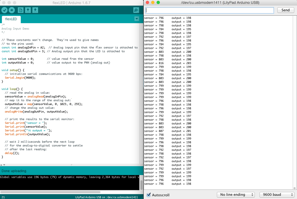

Step 11: Open Sketch
In Arduino navigate to:
File > Examples > Analog > AnalogInOutSerial
Copy, paste and save sketch as flexLED.
Step 12: Upload
Change the pin numbers in the first two lines of code.
analogInPin is the pin your sensor is connected to.
analogOutPin is the pin your LED is connected to.
const int analogInPin = A2;
const int analogOutPin = 3;
Upload sketch and bend the sensor to change the LED's brightness.
Step 13: Get Max and Min
Open the serial monitor to see the sensor's values.
Take a look at the numbers next to "sensor =". When the sensor is resting record the number you see here. The number will change constantly so record the one you see the most and round to the nearest ten. Mine is:
780
Now, bend or press it to the maximum amount and record that number to the nearest ten. Mine is:
1020
Hang on to these numbers, you will plug them into your sketch in a next step.
