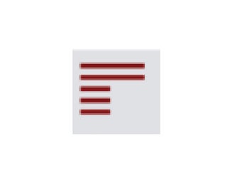

SLICE THE MODEL
Click the Slice icon.
Models generally have hundreds of slices.
The STL file will be hidden. The red lines represent the slices.
  • Once the model is sliced, it cannot be modified without deleting the slices.

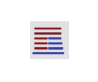

CREATE SUPPORTS
Models with overhanging or cantilevered elements will distort if they are not supported. The software creates supports for any surface at less than a 45 degree angle, but this can be changed in the software. See Shop Staff for assistance if working from Pier 9.
  • Click the Create Supports icon.

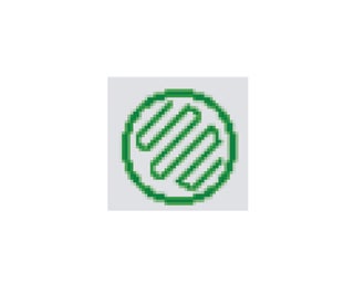

Click the Create Toolpaths icon.
  • A toolpath is a path that the extruder head will follow to lay down the filament.
