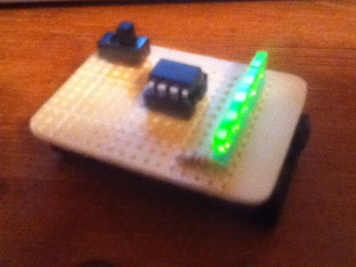

Introduction: $10 ATtiny85/45 POV Display!! (works Really Well)
Hey guys! This is an Instructable for making your own ATtiny85/45 5 LED POV (Persistence Of Vision) display!
This is my second Instructable, also for the Elemental LED contest, so drop a comment and vote it up!
The total parts cost for this POV display is under $10! (If you get the parts from a wholesale supplier, like Mouser or Digi-Key)

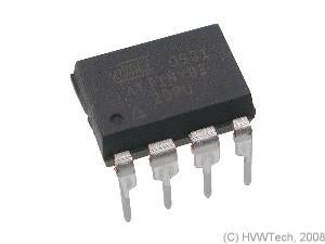

1x ATtiny85/45 microcontroller
1x 8 pin DIP socket

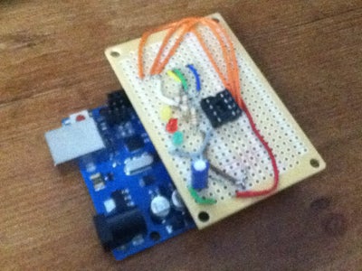

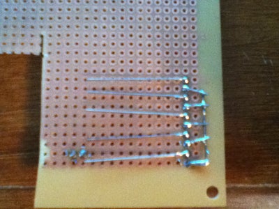

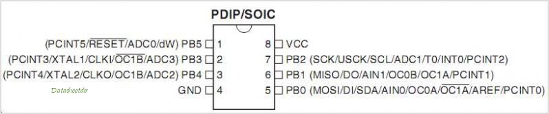

Step 2: Circuit Schematic
Here's the schematic for the circuit. I have attached the Eagle .sch file at the bottom.
Step 3: Program the ATtiny MCU
I made an Arudino sketch to upload to the ATtiny, so the Arduino would be the logical choice for uploading to the ATtiny. You can find a guide on how to do this here. (You can skip the guide if you already know how)
After you followed the guide above, hook up the ATtiny, and upload the sketch.
To change the message displayed, open the sketch, and scroll all the way down to the bottom. There will be a line that says "displayString("wow!!");", you can change the text inside quotes if you want to change the message. After you have done that, just re-upload the sketch to the ATtiny and you're ready to go.

Step 4: Breadboard It!
Now assemble the circuit on a breadboard to make sure that it is working properly. Power it with a 3 volt power source (such as 2 AA batteries or a CR2032 3V coin cell battery)
Make sure that the LEDs are in the right order. I will put the LED order first, and then the ATtiny pin it connects to.
Top LED - pin 3
Second LED from top - pin 2
Middle LED - pin 7
Second LED from bottom - pin 6
Bottom LED - pin 5
Top LED - pin 3
Middle LED - pin 7
Bottom LED - pin 5
Step 5: Solder It!
When you have made the circuit on a breadboard and checked that it is working, you can solder it to a small piece of perfboard.
I used a piece about 12 holes long by 17 holes wide, but I'm sure you could make it smaller if you want.
I used rectangular 2x5mm LEDs because they fit right next to each other without a gap on the perfboard, and that makes the picture look better.
Step 6: Make It Look Nice!
I attached the battery pack to the back of the perfboard with hot glue, and then I used my Dremel to cut the part of my perfboard with the circuit on it to as small as I could. Then I used a sanding bit on the Dremel to make the edges nice and smooth and rounded.
Now it looks a lot better ;)
Step 7: Now You're Done! Good Job!
Now you can test out your brand-new POV display. You can change the text that displays on it as many times as you want by simply hooking it back up to the Arduino for programming, changing the message at the bottom of the code (in to "void loop()" function), and re-uploading to the ATtiny.
If it is not working, try using it upside-down instead.
Have fun!
Have fun!
