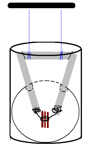

Step 3: Prepare the Mold and Add Weight
Take your rubber ball and wrap it liberally in plastic packing tape or duct tape. This is to reinforce the rubber because it will warp significantly when you deflate it and pour in the concrete. You can also use a slurry of plaster of Paris, or plaster-impregnated gauze strips to coat the outside -- these will be more expensive and time consuming, but will product much more aesthetically pleasing results.
Leave two holes about 4 in. apart big enough to put the two arms of our rebar handle through. When it's pretty well covered, cut the holes out with a utility knife and connect them with a slit. The ball will probably deflate a little, but the tape should keep most of it in place.
(see crappy MS Paint image for details)
Once you have the holes set up and the slit in the middle to pour the concrete in you can fill it with water to figure out exactly how much concrete you'll need to mix, but be careful: the rubber is pretty fragile and even with the tape, it will rip easily. You can also get a slightly less exact measurement by calculating the volume of the ball. Most basketballs = 8.5 liters.
To add weight, simply take your plates, scraps, etc. and attach them loosely to the bottom of the handle with wire. It doesn't have to be tight, it just has to be centered between the arms at the bottom and not hanging too far down.
Put the mold in your first bucket and pad it with some newspaper to keep it centered.
Step 4: Suspend, Mix, Pour
Take your handle and your mold and suspend the handle so that it is positioned in the mold. I just took two long pieces of string and tied them to some ceiling beams in my studio and tied them to the corners of the handle until it hung parallel to the ground with the arms low enough down to sit in the mold in the right place.
Dry fit the arms into the holes you have cut in the mold. Make sure the arms stick far enough down into the mold and that they are not so high up that you have a giant handle.
Once it's all positioned, you can mix your concrete. I typically just mix by hand in a big bucket since it's only a small amount. Pour in however much you need to fill your mold. Add water until it is workable, but not watery. it doesn't have to be perfect, but the more water you have the weaker it will be when it dries and the harder it will be to work with.
Pour the concrete into the mold. You can cut the top off of a wide-mouthed 2 liter bottle and use it as a funnel if you don't want to be messy, or you can just pour it in a scoop it out with your hands. The ball will stretch slightly and flatten at the bottom. This is fine. you want it to sit flat on the ground. Once the ball is about full, position it under your suspended handle piece and lower it into the filled mold. Reposition as necessary. Let set and dry for a day or two (or more depending on concrete mix and water ratio)
