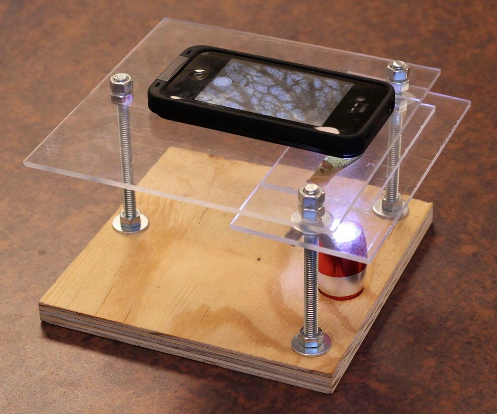

Step 1: Materials and Tools
The cost of this project is just $10 (not counting the smartphone), and it only takes about 20 minutes to build. You can be viewing cells with your smartphone within the hour!
Materials required:
3x 4 ½” x 5/16” carriage bolts
9x 5/16” nuts
3x 5/16” wing nuts
5x 5/16” washers
¾” x 7” x 7” plywood  -- for the base
⅛” x 7” x 7” plexiglass  -- for the camera stage
⅛” x 3” x 7” plexiglass  -- for the specimen stage
Scrap plexi (~ 2"x 4") for specimen slide (optional but useful)
laser pointer focus lens (use two for increased magnification)
LED click light (necessary only for viewing backlit specimens)

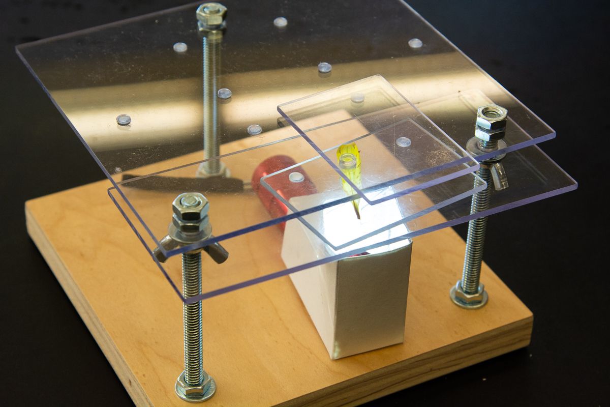

Step 4: Drilling the Bolt Holes
Make a mark with a Sharpie on the front two corners of the plywood base ¾” from both the sides and the front edges.
Put a sacrificial piece of wood beneath the plywood base before drilling.  You don’t want to damage surface of the bench! Stack the plexiglass camera stage (7” x 7” piece) on top of the base.  Then stack the specimen stage (3” x 7”) on top of the camera stage with ¾” of the stage extending off the front of the base.
Drill through the entire assembly.   The bolts that stick up through the base must be countersunk in order for the stand to sit flat.  Flip the base over and counter sink the holes with a spade bit.
EDIT: A few tips on NOT cracking the plexiglass when drilling…First, go slow.  Let the drill do the work and DO NOT press down hard on the drill.  Use a sharp bit and press gently on the drill.  You can also put a piece of tape over the area that you wish to drill through.  It will reduce the chance of cracking the plexi.

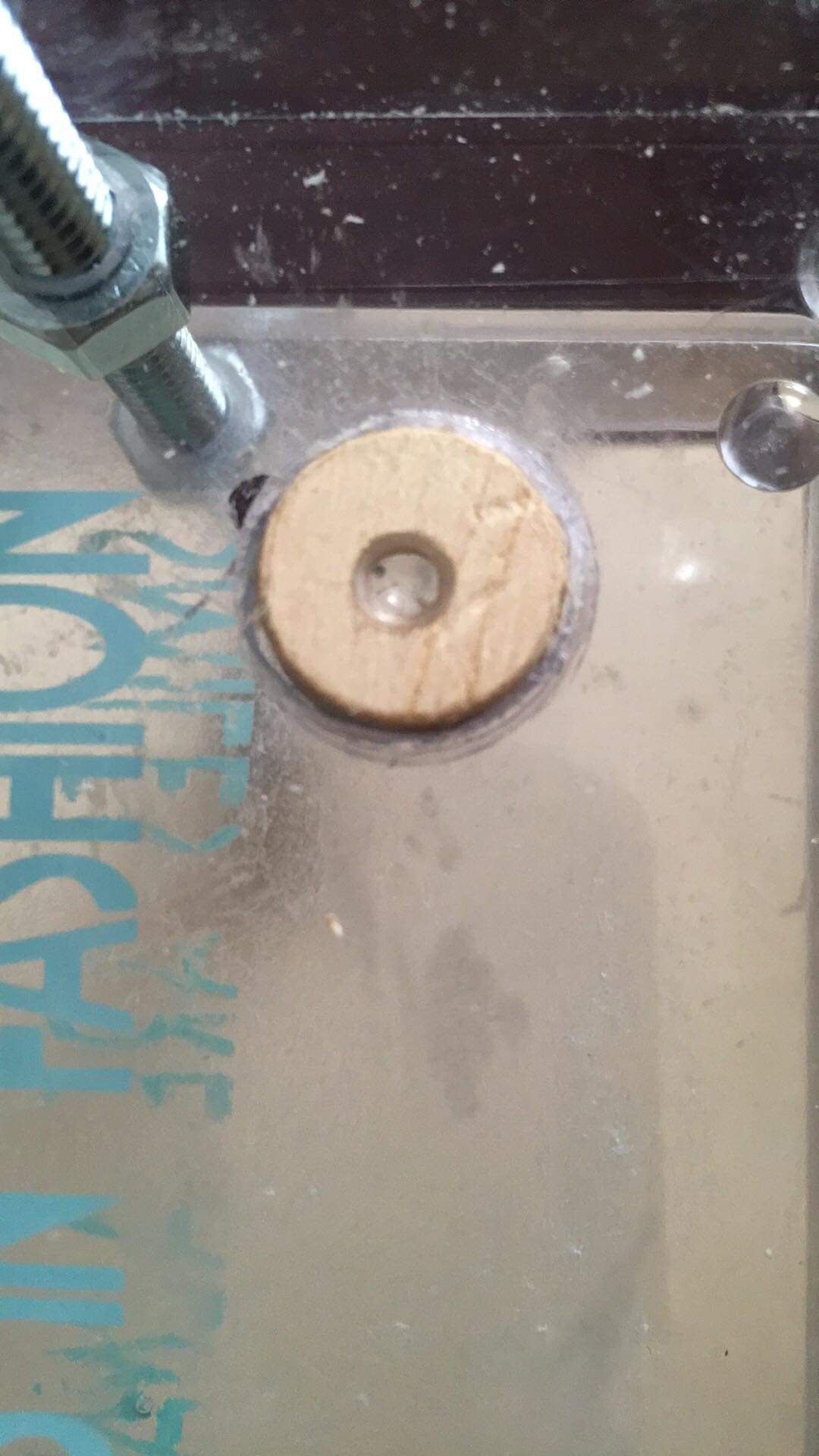

Step 5: Embedding the Lens
Find a drill bit that is the same size as or smaller than the diameter of the lens. Remember, you can always take more plexi away; adding extra plexiglass after drilling is not an option.
¾” from the front of the camera stage (in line with the bolt holes) drill a hole for the lens.
If the lens doesn’t quite fit, file or use sandpaper to enlarge the hole.  Be sure to do this slowly and test the fit often.  It is easy to overshoot and make the hole too large!
When using the stand, it is important to have the lens as close as possible to the camera.  If you don’t plan on having your phone in a case when you use the stand, make the lens flush with the stage.  Otherwise, leave the top of the lens slightly exposed (as is done in the image) so that the lens will rest closer to the camera.
EDIT: If you are using TWO lenses, stack them on top of another.  Insert one lens from below the plexiglass and the second from above.
Step 6: Drilling the Hole for the Light Source
It is important that a hole for your light source is directly below the focus lens.  The best way to mark the placement of the light is to slide the camera stage (without the lens) down to the base, mark with a pencil where the hole is to be drilled, and drill a shallow hole to rest the light in.
Step 7: Assembly
We are ready to assemble!  Start with washers and nuts to hold the bolts tight to the base.  Then add some upside down wing nuts and then washers to the two front bolts.  Place the specimen stage on top of the washers and add a nut to each bolt. Lower them about 1/2” and rest the camera stage on top of these nuts.  A level is handy here to make sure that the stage is actually flat.  If you don’t own a level there are plenty of free level apps for a phone!  When the stage is level both front to back and left to right, tighten down the final nuts.

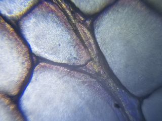

Step 8: Explore!
Go take some pictures! Or video! With $10 worth of materials and a smartphone, you just made a digital microscope!
Plant cells tend to work best for this particular model, but feel free to experiment. That’s what this is all about, giving you the freedom to explore.

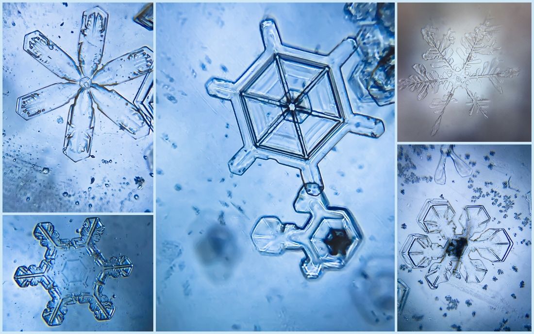

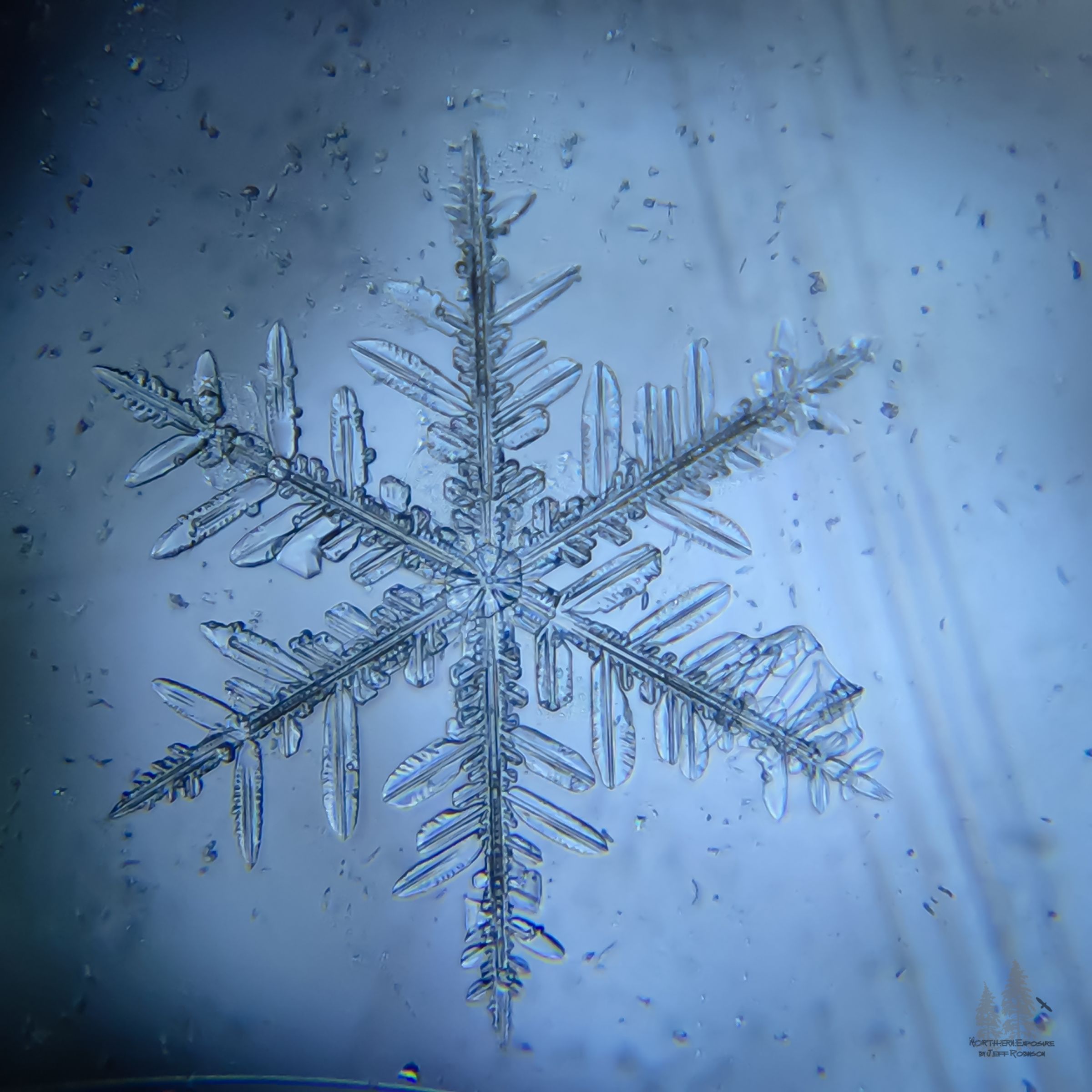

Do you think this would work to take pictures of snowflakes? I'm thinking of building these with my Grade 10 science class
JeffR178
JeffR178
Reply 5 years ago
It DOES work very well for snowflakes...but you have to have the entire scope outside so your stage and slide are cold so the snowflakes don't melt. I took this image a couple of days ago.
0
Yoshinok
Yoshinok
Reply 5 years ago
This is a magnificent shot. I am giving a presentation to my colleagues about the response of the online community to my instructable/microscope. Would you mind if I used your photo? I've sent a PM and would like to be able to make all appropriate attributions. Thanks!
0
JeffR178
JeffR178
Reply 5 years ago
Yes, by all means, you may use the photo. I'm new to this site and am having trouble finding my PMs in Safari on my iPhone. I have a few other snowflake photos as well, if you are interested.
0
Yoshinok
Yoshinok
Reply 5 years ago
I would absolutely love that! Thank you! If you are comfortable,feel free to post them here, or I can send you my personal email.
0
JeffR178
JeffR178
Reply 5 years ago
Here are a couple more images, one is a collage with a few "flakes" that were more like ice crystals. I also have a few images posted on my Facebook page: www.facebook.com/northernexposurebyjr
