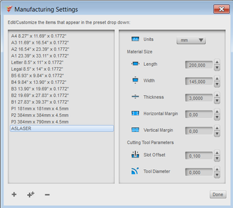

2.- The next thing is to setup your cutting surface depending on the size of your machine (mine is A5).
It is very important to use the right thickness for the material you´ll be using (mine is cardboard 3mm).
