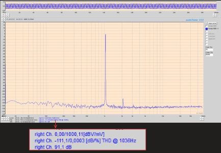

The measured specification of the module:
Frequency:           1036 Hz (before using selected parts for C1, C2, R2, R7)
Signal level:          1000 mV rms / 0dB
Distortion:             0.0003% / - 111dB
Signal/noise:          - 91.1 dB
