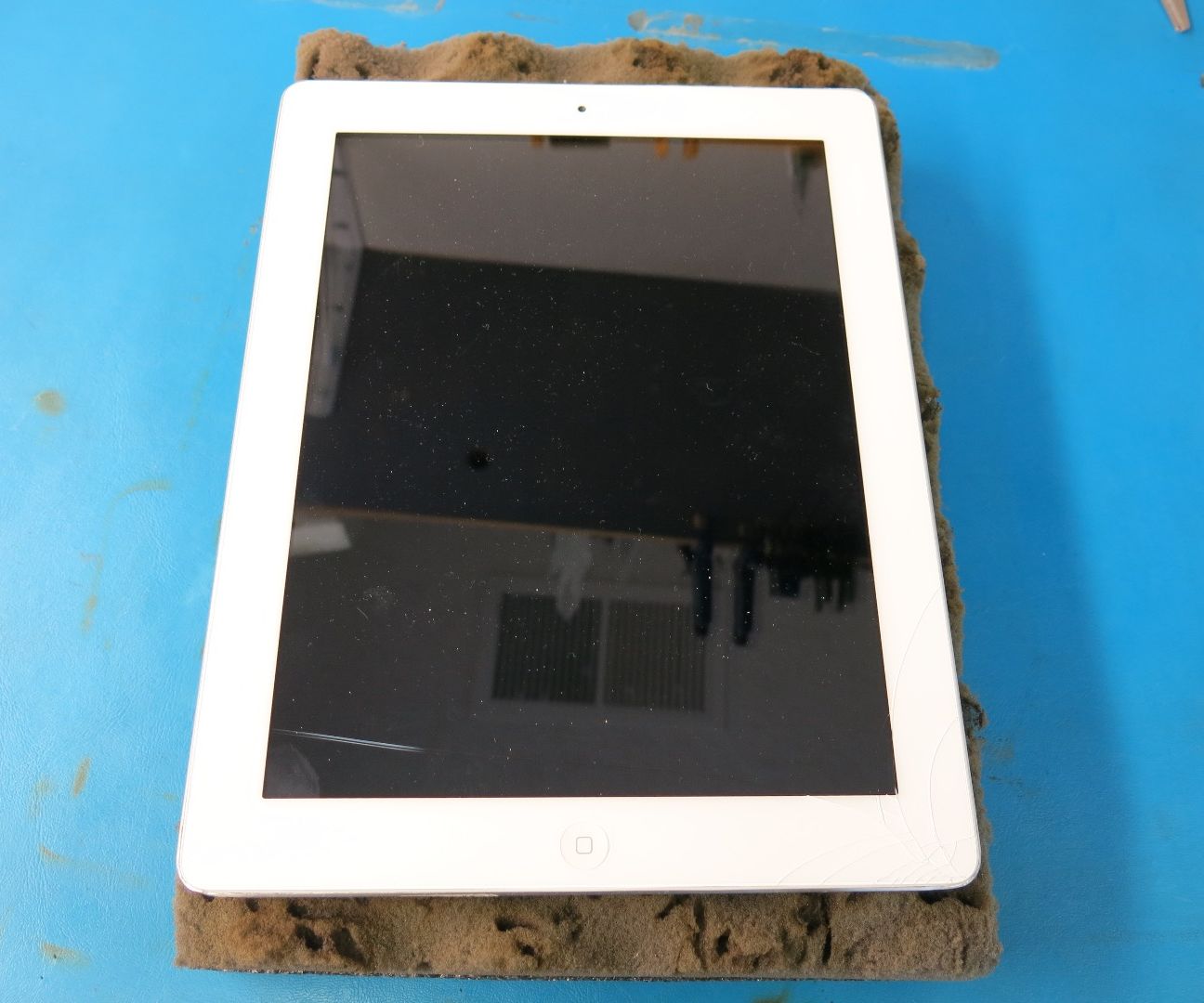

You will be starting your repair by removing the iPad Mini digitizer. Prepare by gathering your tools and materials and finding a clean and flat surface to work on.
Step 3:
We recommend that you wear safety glasses to protect your eyes, you should also be careful and aware whenever operating the heat gun.
  • Turn your heat onto a medium or low setting. Temperatures may vary depending on your heating device, so you may need to adjust the heat to what suits you.
    • Were using a heat re-work station, since we repair thousands of iPads, but you can use a hair dryer or generic heat gun at low temperatures.
  • On your clean and secure workstation, place the iPad in front of you in a portrait orientation. Make sure that the power button is way from you and the home button is closest to you.
  • Start by heating the bottom left corner of the glass around the edge. Be careful to only apply heat to the glass that covers the frame and not the glass that covers the LCD. Refer to the annotated image above for clarification.

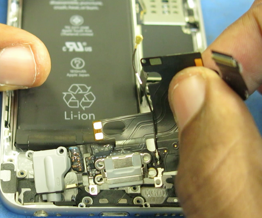

Step 8:
Take a second to again familiarize your self with the locations of the two antenna cables at the bottom of the iPad.
  • GPS antenna cable (bottom right)
  • Wifi antenna cable (bottom left)
Step 9:
  • Leave your spudger in-between the glass and metal frame at the bottom right corner.
  • Apply heat to the glass digitizer over the location of the antenna cable. It's okay to use a bit more heat here, the heat really helps release the adhesive that connects the cables to the digitizer.
  • Use the spudger to pry upwards on the glass frame near the GPS antenna cable and create space. You should be able to peer in-between the glass and frame and see the glass start to separate from the cable.
  • Once you are confident the adhesive is separated, slide your spudger over the GPS antenna cable along the frame towards the Wifi antenna cable.
Step 10:
  • Continue using the technique you used in the last step. Apply heat over the location of the left antenna cable (Wifi cable), use your spudger to pry up on the glass digitizer to separate the adhesive.
  • If you use enough heat here, as you pry you should start to see the glass lift and seperate on its own.
  • Move your spudger over and past the wifi antenna cable and through the bottom left corner where you initially started.

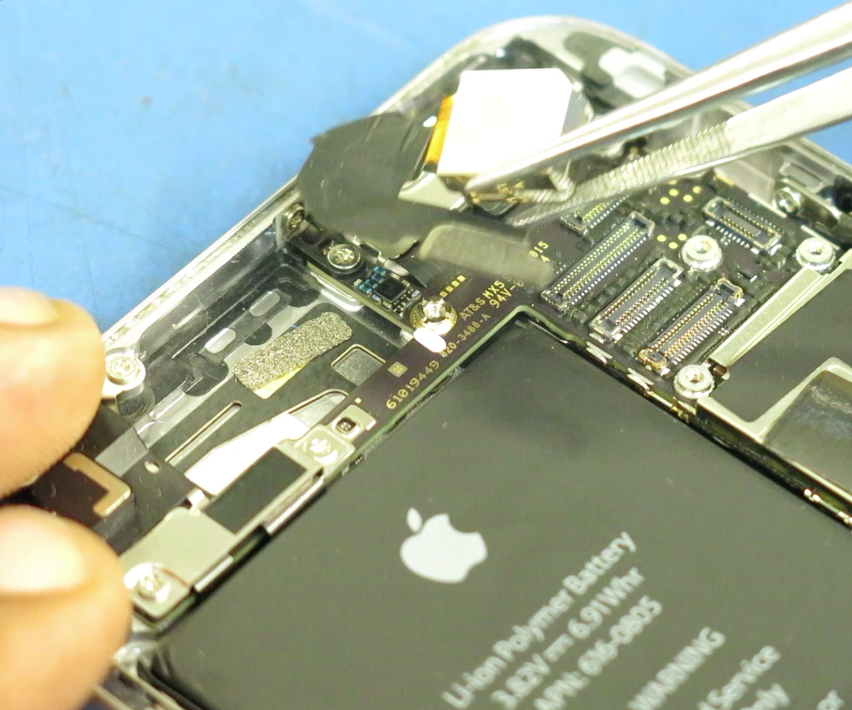

Step 20: Removing the Camera
  • Look to the top f the iPad. Use your tweezers to remove the black tape covering the front camera connector.
Step 21:
  • Once you've removed the black tape, use your spudger to gently pry loose the front facing camera connector.
Step 22:
  • The camera sits inside of a plastic bracket and the cable is threaded through this bracket.
  • Remove the camera, pulling the camera through the bracket as you do. You may need to use your plastic spudger to gently pry the camera loose from the adhesive holding it in place.
