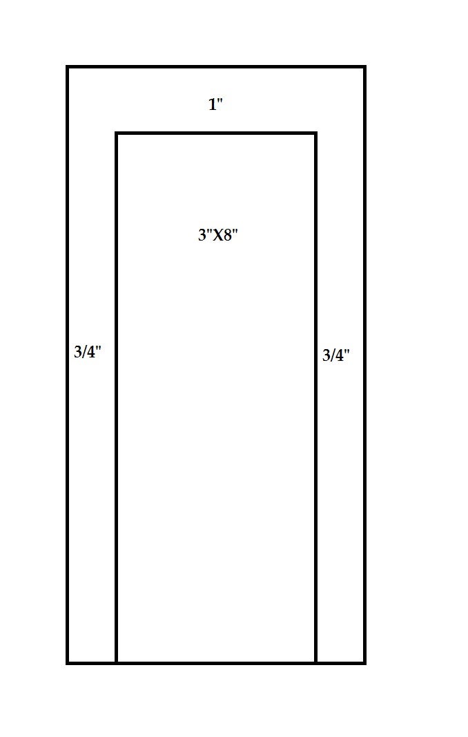

I decided that I needed an 8"x3"X3" chamber, so I marked the brick with a permanent marker.
Step 1: Drilling
Using the 1" spade bit, I drilled out a honeycomb from the soft brick to a depth of about 1 1/2". I marked the spade bit to how deep I wanted it to go.
I took my time because of the soft nature of the Fire Brick, I didn't want to crack it.
Once I drilled out the chamber I used the 5/8ths bit to drill the hole to insert the burner.
Using the chisel as a scraper, I smoothed out the chamber floor and walls.

Nice Forge, I'm going to try to make one only use 4 Bricks, the ones shown as the ends and 2 more for the top and bottom pieces to give more surface area plus making the forge a little bigger. Any reccomends for a morter or Cement to hold them together that will with stand the heat?
0
squirejoe2
squirejoe2
Reply 1 year ago
I used the pressure that was created by the angle braces and the screws on the threaded rods. I did not use any mortar or cement. Those held up well and also helped keep the whole assembly together when thermal cracking occurred.
I know Home Depot and Lowe's carry a Furnace Cement that is rated to 2000 degrees f. Maybe between that and the angle braces, it might help, but that is just a guess.
Let me know how that goes!
