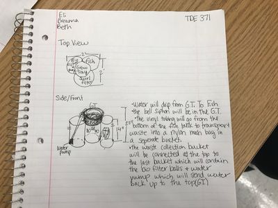

Step 2: Brainstorm Ideas
Our group remembered the constraints and started trying to plan accordingly. We knew we had 5 buckets to work with and we knew we needed a least 4 different compartments. We thought about what are system needed to focus on the most and that was the fish, the plants, and the filtration. We knew we needed exactly one bucket for the plants and two buckets for the filtration. Since we knew each of the tilapia fries needed 3 gallons we thought we might use 2 buckets to house them. With 2 five-gallon buckets, we felt we could appropriately house 4 fish. We thought we could also use the extra bucket to separate the bio balls and swirl filter.
Step 3: Create a Plan
After getting our actual materials that we were working with our designed changed a little. We also decided to consolidate the mesh filter and bio balls so that we could have an empty bucket for adding chemicals and monitoring the water. Our final system had water flowing from an elevated grow tray held up by an upside-support bucket. the bottom 3 buckets would be for the fish, the filtration bucket, and the monitored bucket.
