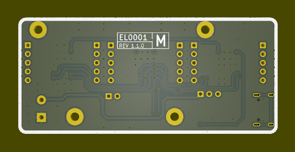

Step 3: Printed Circuit Board (PCB)
The printed circuit board (PCB) of this module is design using KiCAD. The dimension of the PCB is 75.25mm × 33.75mm. To build this PCB, use a 1.6mm FR4 board with a 1 oz thickness of copper.
The parameters to manufacture the PCB is in the below list:
- Width: 75.25mm
- Height: 33.75mm
- Number of layers: 2
- Material: FR4 (TG 130-140)
- Thickness of PCB: 1.6mm
- Copper weight: 1 oz
- Surface finish: HASL lead-free
- PCB solder mask: Green
The PCB for this module was fabricated by PCBWay, who generously sponsored this project. PCBWay offers high-quality PCB manufacturing and assembling services. Also, they offer CNC and 3D printing services. The PCB of this module is available to order from PCBWay. Check out the PCBWay website for its manufacturing capabilities and pricing.

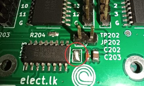

Follow these steps to flash the firmware:
- Ensure that JP201 (the jumper pads next to the STC15W201S MCU) is in the open position. By default, this jumper is open.
- Connect the module to your PC using a USB to Type-C data cable. Make sure that JP203 is set to external power mode and apply 5V power to the module.
- Run lsusb to ensure that CH340N is detected by the operating system. Use the dmesg command to find the path to the serial interface. The Makefile assumes the module is mapped to /dev/ttyUSB0; if it is not, update the FLASHDEV variable in the Makefile with the correct path.
- Type make flash in your build environment. If everything is set up correctly, the programmer will be ready for the next power cycle of the STC15W201S MCU.
- Short the JP201 jumper using a metal tweezers or screwdriver, and hold it until stcgal uploads the entire firmware to the device.
After the upload is successful, disconnect all connections from the module and permanently short the JP201 jumper by soldering it.
