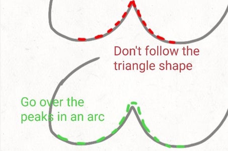

//Tip: with the legs, sew in small arcs, not triangles, e.g. first picture. Arcs keep the shape better.//
