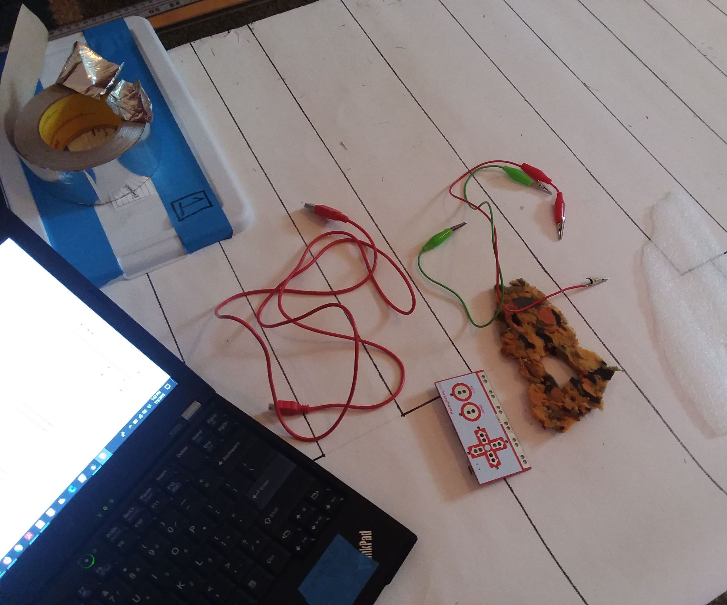

    Step 8: Connecting to the Makey Makeys
    This was a critical step because it tests all the connections.
    While building this project, I only did (1) set of Cat5 Wire as a prototype.
    1. Connect the Cat5 Network Wire to the Low Voltage Data Box. It helps to mark the Jacks 1-4 so you know where they are originate on the piano.
    2. The next step is fun, but can be a wiring nightmare. This is the real test of the logic of your initial wiring. Any sketches that you did in a Design Journal help.
    3. Use the Test Leads (Alligator Clips - Makey Makey) to connect the Console to the Makey Makey.
    4. I advise to apply some logic to this process. I set my project up so that Makey Makey #1 was the Lower Octave - with lower C starting at Key "Z" and run through 18 inputs.
    5. This is where you need the Makey Makey Remap website - https://makeymakey.com/pages/remap
    6. I created a Google Doc to document the Keyboard Remapping.If I had to do it again.
    7. I setup the Makey Makey #2 to be mapped out following the Garageband Typing Keyboard map. This is helpful if students wish to work in Garageband or Logic Pro - https://makeymakey.com/pages/remap
    8. Another type of mapping could follow the MidiMidi mapping. Thanks to Hauke Menges at Feel Your Sound for this wonderful addition to the Makey Makey use - https://makeymakey.com/pages/remap
