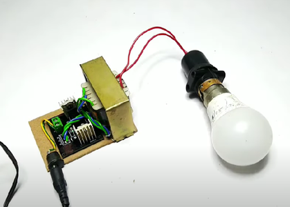

Here we are using Transistor
We are using Heat Sink because our power transistor gets very hot so we are using a heat sink to keep it cool. 1st we joint the heat sink in the transistor.

After assemble we soldering all the component and our PCB look like
Here we are using a 12–0–12 (1 Amp ) transformer , {you can also use a 2,3 Amp transformer }. We will connect the three wires of the transformer to the PCB. On the PCB board it is mentioned where to add 12 Volts wire, and where to add center dept wire and solder it. Our transformer connection is done.
                            12–0–12 (1 Amp) transformer
Now we are using 12 volt female socket using input, so we connect female socket to the terminal point
Now we connect our transformer output in a bulb holder
Step 4: TESTING
Lets connect to the 12 volt output in the PCB and we will test with a multimeter, then we are using a 9 volt led bulb.
